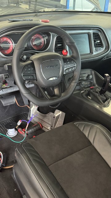

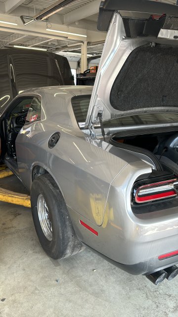

Due to time constraints and the fact that my buddy had a brand new Trackhawk 8HP95 kicking around we decided what we would do is gut the HP95 and put everything in my HP90 case. Easy enough, right? Wrong. There are case differences, and the the front pump/housing/clutch assembly (I'm not a trans guy, I'm not sure what it's called) doesn't fit as it's just a touch larger than the HP90 assembly and gets hung up on the case.
At that point, we had ten days to get the TH400 in and make the event. That day we test fit the trans, found out we had the wrong bellhousing, and got all the parts we needed ordered rush delivery. A few days later, we got back to it with all the parts, decided to go the David Freiburger motto of "don't get it right, just get it running" for the event, and swapped in a Hellcrate harness and PCM.
My tuner was on Vacation so with hours left before we had to leave for the event I just copied my tune over from my pcm to the hellcrate PCM and we got the car up and running. Went out to try the transbrake and bump box and under full throttle the car just closes the throttle blade to 17% and opens up the supercharger bypass.
We ended up deciding to leave the car at the shop and go out and support our friends in the drag and drive, as opposed to bring the car and start fighting with it. I think that was the right call and allowed us to enjoy the event and just hang with friends.
I'll have to figure out what's going on with the car, I'm sure copying the tune right to the hellcrate PCM probably wasn't the best way to go but I didn't have a ton of options at the time. We are swapping manual harnesses into the car and I'll have to get my PCM bench flashed to a manual OS. Eventually I still want to go with a Holley dominator setup but I'm having a hard time opening my wallet for it knowing just how much other stuff the car needs as well. I am definitely playing with fire with the stock bottom end and I don't feel great about it.
