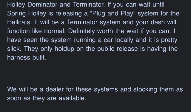

Just got this juicy bit of info from @ostmike ill probably start with this then move to a dominator ECU and sub harness when the time comes as it would be cool to have it be like factory style integration. I know it goes against my buy once cry once scenario, unless it can be paired with a Dominator right off the hop.

I believe so, I’ve seen what has seemingly looked like plug and play setups from Holley running on cars but no official word from them on anything.
@ostmike do you need a test mule? I'm willing to front the money in advance to be on the ground zero.
This system is already tested and ready for production. Contact us in the Spring - -we will be taking "pre-orders" once we have a confirmed date.
This would be the setup to use for a car that you might want to keep intact for resale someday. I had not heard about this being in the works. This would allow you to just bypass all the nannies that get in the way with the OE computers. That being said…. I have yet to see any aftermarket thing like this get to market on time. I’ve become very pessimistic on expected availability dates. Good luck 👍🏼
It has been in the works for quite some time. I actually thought we would have them on the shelf earlier this year but as you indicated getting a final product to market like this in a timely manner is not common.
