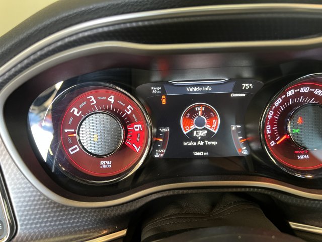

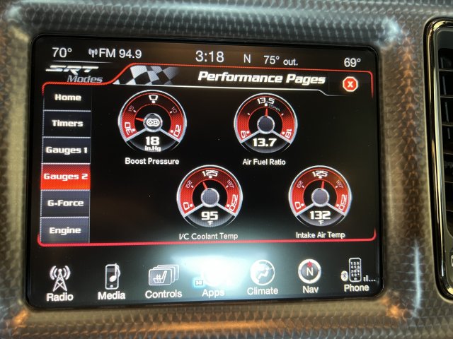

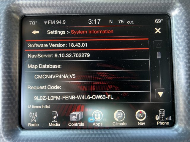

Assuming there is some "function" to load software from a USB or SD card and you can simply select the file to be loaded, theoretically you could load any version you want.
FWIW, this is the software version that I loaded with a USB drive some time ago. The IAT matches. ('16 M6)
17,678
55,290
#54
4,902
19,630
#55
7,644
20,030
Thread Starter #56
That all looks correct to me?
4,874
25,960
#57
My 2015 auto has 18.45.01.
AeroF16
#2826
2,197
7,018
#58
7,644
20,030
Thread Starter #59
You know what I meant lol
19,339
101,272
#60
I believe that's the most current one when I checked the Uconnect update site, today. Are your IATs in agreement?
