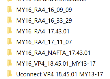

Guy that goes by Ccso77 on the other forum figured out P/Ns that would plug and play swap Uconnect for the new models. There had been some discussion of heated/cooled seats and other items not working but for 2016 and up it's a drop in replacement. For 2015 models you'll need a body control module (BCM) from a 2016 and get it flashed with your car's VIN, then it will also work.

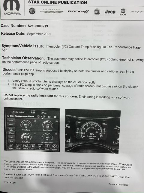

Two things aren't perfect. Launch Control is stuck at 1,000 RPM (although mine goes to 1,500 which I think is the last setting I used on the old Uconnect) and the Intercooler Coolant Temp doesn't register. Not sure if that's a software problem or a sensor problem. When I swap to the Redeye supercharger next month I'll know if it's the sensor.
Install took 30 minutes. Took about 4 hours for all the software to update. Locking the car and moving the key fob away for an hour "may" speed that up.
