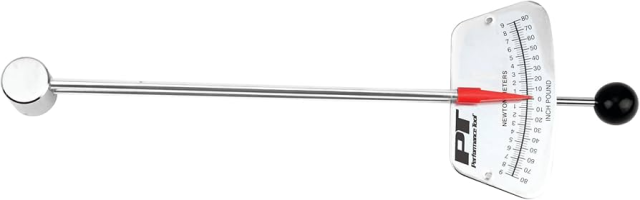

This works good
Especially with 2 bad shoulders & the shakes
