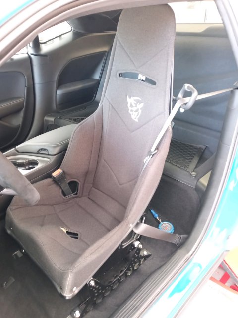

Very comfy though with the cover, easy to get in and out of since steering column doesn’t move. I like it

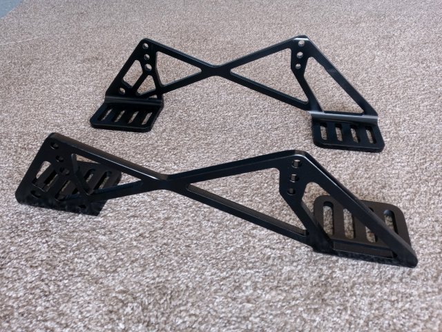

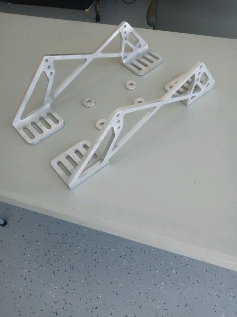

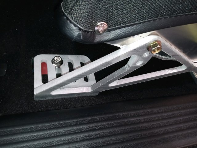

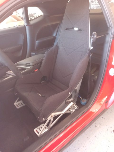

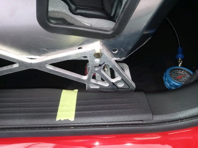

OK, so if you do not want to make your own brackets we have come out with some that are really trick. They are really strong considering how light they are. Made from 3/8" aluminum. I was buying brackets from OMP for about $210 shipped and then extensively modifying them. Now you can buy these and use them as is. They are about 2 pounds each. $450 a set. I beta tested some with a 20" kirkey today. They will also work with a 18.5" and they can be used with a 17" along with spacers same as I was doing before.

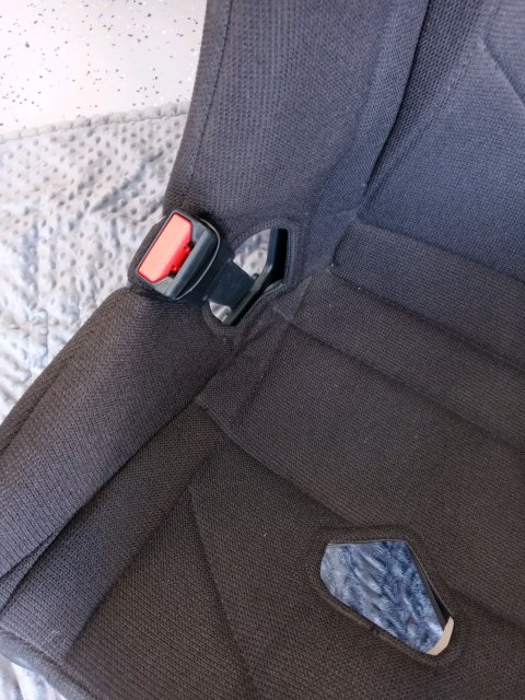

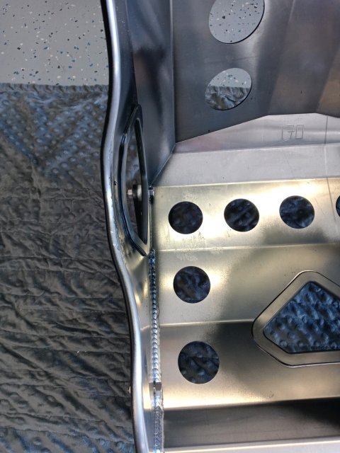

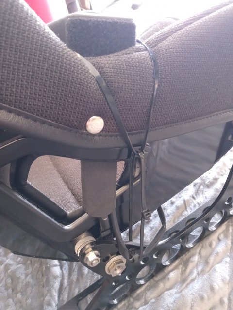

OK Guys, get out the Sledge Hammer. Well really a Single Jack. This has been on my list of honey doos for a while. And my Demon 170 Jailbreak activities have been put on temporary hold.
I did 2 things. I modded the seat to put the seat belt buckle inside and I routed the anchor side inside the cutout. Feels a little better when I am belted in. Likely a little safer if....................
Last pic is the old way........... 0607241449a_HDR.jpg 0607241508.jpg 0607241508a.jpg 0607241539.jpg
