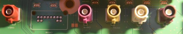

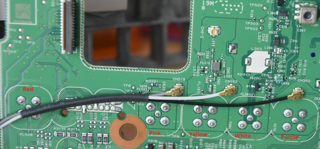

1. Did this. In fact, did it both externally AND internally. There are 3 small coaxial leads that run from the main PCB (from the FAKRA input traces) to the AirCard. I pulled all 3 of those small internal connector wires off, system still receives the same level of 4G signal. I'm satisfied that there's an internal antenna on that AirCard somewhere.
2. The path for the internal coax antenna connector cables is pretty straightforward.
The headers are in this order on the back:
And the traces look like this:
As the colors are labeled on the AirCard, the black/white/gray leads match those. (See earlier photo of AirCard)
The empty coax connector in this photo (CN512) goes to the main board and attaches to the large silver SiriusXM radio tuner. This makes sense as the satellite antenna (white coax internal cable) goes to both the AirCard for GPS and the SXM Tuner for radio.

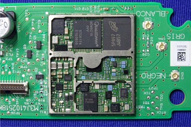

I find it highly unlikely that there's an antenna embedded on that card from what has been shown so far. I don't see it on the pcba, so if it's somehow under the shield as part if the sierra chip, try to wrap your cloth over the chip area and see if the signal drops out. They might just have amazing sensitivity in the unit and you need more isolation.
Have you tried the assist button with the blocker on?

It's going to be a few days before I'm able to attempt the full shielding of the AirCard, waiting on some supplies.
Older uconnect(VP3/4) teardowns show an AR5550 from sierra.
I'm thinking simpler than antennas, just a signal generator straight into the fakra connectors that sweeps constantly to confuse the chip. Would take a little design to impedance match the expected 10k antenna to a typical 50ohm output, but you can get really cheap signal generators online that go up to 4GHz.
Biggest issue I see with this is the car is always 'on', so the signal generator would be a parasitic draw even when parked unless coupled with a radio kill switch. I'd sooner yank the chip.
#19817
36
15
Mount Pleasant
SC
2023 Challenger
Better photo of the guts of the AR7552 card, heat spreader off, courtesy of the FCC:
