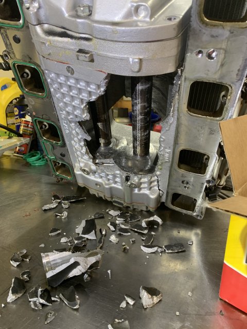

I agree with you on the heat and speed. My rotors exploded into 1000 pieces as a likely result of blower RPM and took out my engine along with it. When I wrote about it in the other forum, I had a vendor reach out to me with having the same thing happen to 4 other cars, mine being the 5th he knew about. I then had 2 other individuals later contact me with blown up superchargers looking for answers too.
The common denominator- High RPM. All cars were modded and they all let go running 6500-7000 which translated into 21,000-23,000+ blower speeds depending on pulley combos. Stock calculates out to about 14,800. Too much heat and/or too much speed can be catastrophic to these cast superchargers. Yes, a lot of people have gotten by with no issues at all. Some have not.
This was my personal justification for a bigger and billet supercharger vs stock. At $7k it’s not cheap but it was certainly a cheaper option than the almost $10k Redeye/Demon blower. Contrary to other opinions, this was a no-brainer for me. Far less blower speeds, billet vs cast and all for less money??
One s/c failure cost me enough so I’ll take the safety of an upgraded unit over a record timeslip any day.
