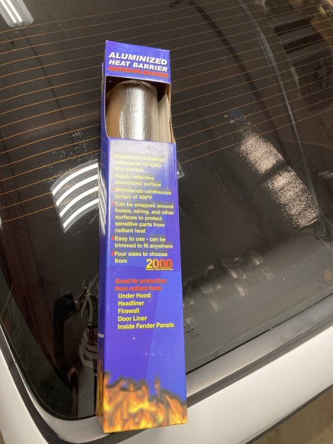

How bout this, I’ll try and get some more of this Pyrol stuff this week, I coat the back of it with this stuff that I’ll have to buy more of, I over spent on car stuff over the last sick week, with being off work I could use some funds. Instead of taking time getting poster board, making tracings, mailing them I just make some of these for you guys out of Pyrol for $50 each PayPal’d and shipped? Nobody PayPal me anything yet because I have to contact my buddy this week and see if they have some scraps around or not. And I have to order some more of this stuff, it coats the under side image.jpg

This stuff is called Pyrol, it’s a insulation board that can make a claimed 300 degree temperature difference in a 1/8” thick piece. Used it where I used to work between 500F blown film die and it’s 45F airing that would sit right on top of the hot die. I coated one side with sticky back high temp insulation foil and spray painted the other side black so it’s less noticeable. My intake tube and snout are now the same temp as the air coming through them verses hot as hell from the hot air the radiator fan blows on the tube if not shielded. Been running it for about 6 months now, no issues. This piece is cut for no hyd power steering pump, if a pump is in place it gets a square cut out of it. It’s hard for me to get this material as it’s like 1000$ for a 4x8 sheet but I get scrap pieces from a guy that still works there but not often unfortunately.
