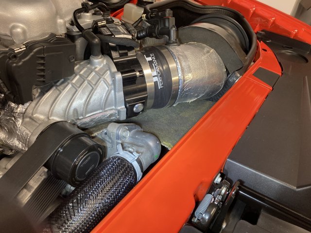

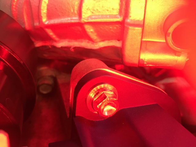

When I installed the SC spacers and thermo blanket I extended the thermo blanket under the snout just aft of the TB. It helped on both cars. 60BE3476-6A3A-4F97-8991-4D325FAD5BEB.jpeg

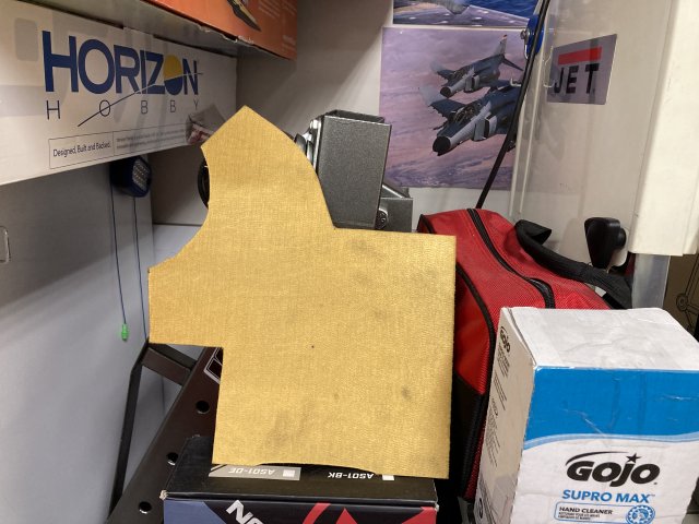

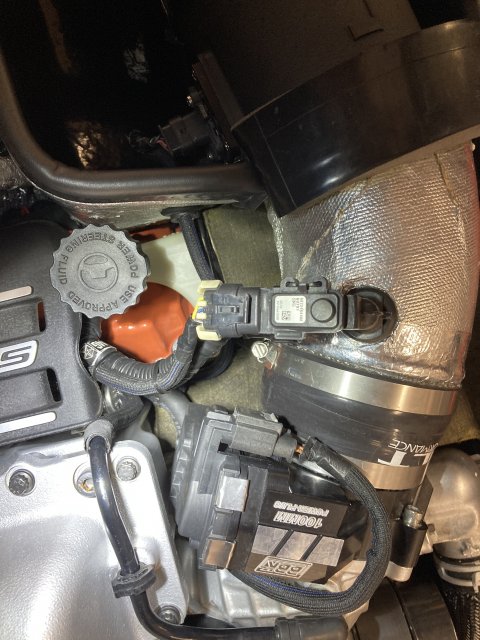

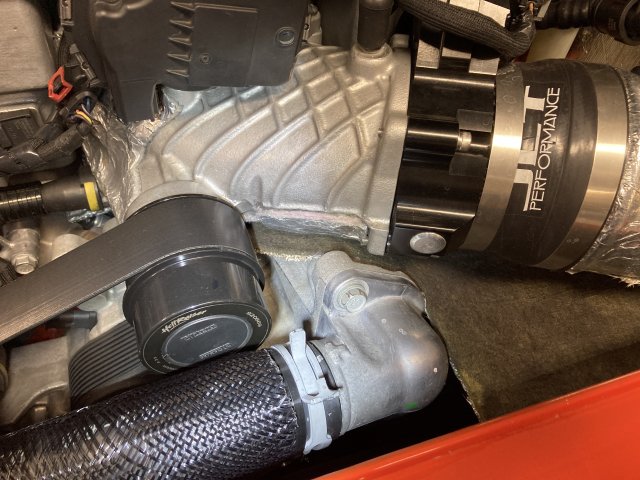

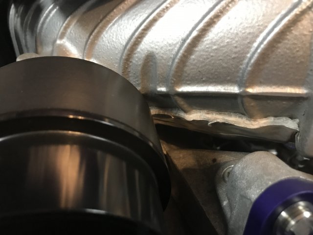

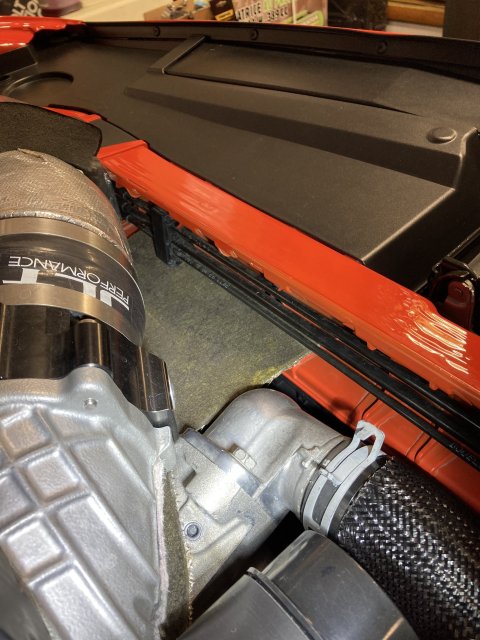

This stuff is called Pyrol, it’s a insulation board that can make a claimed 300 degree temperature difference in a 1/8” thick piece. Used it where I used to work between 500F blown film die and it’s 45F airing that would sit right on top of the hot die. I coated one side with sticky back high temp insulation foil and spray painted the other side black so it’s less noticeable. My intake tube and snout are now the same temp as the air coming through them verses hot as hell from the hot air the radiator fan blows on the tube if not shielded. Been running it for about 6 months now, no issues. This piece is cut for no hyd power steering pump, if a pump is in place it gets a square cut out of it. It’s hard for me to get this material as it’s like 1000$ for a 4x8 sheet but I get scrap pieces from a guy that still works there but not often unfortunately.
76E47851-37B3-46A8-8B8F-A3D16754E46B.jpeg F30F572A-F437-45B8-A54E-FEBC6AE409AE.jpeg 02B581CD-A015-404D-A958-0750CE8FADB0.jpeg 3846E63D-835F-4994-B759-3011DEA6A0B6.jpeg 4A797E03-D55F-4FB9-B78E-6A2DA7397D2E.jpeg
