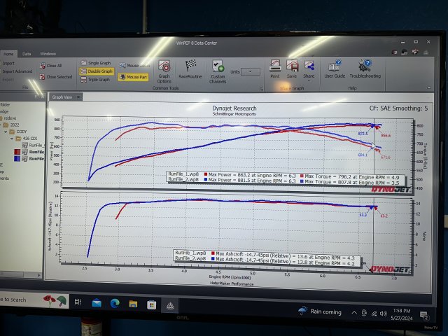

Enjoyed getting to see @Jon-MooredPerformanceLLC and Jim @Hatermkr work together to dial my car in today on Jim’s dyno. Both awesome guys who have gone above and beyond to right the wrongs of the last 8 months and I cannot thank them enough.
We ended up making 882WHP and 808TQ on 100 octane with a 2.85 pulley and 863WHP on 93. These were all done in 5th gear so probably pretty close to 900 if done in 6th, which would be 1:1.

Overall, I’m extremely happy and excited not only to get this car back but also to enjoy what surely is a one off performance build. I effectively have Demon 170 power but achieved mostly through displacement with a much lower amount of boost. Should lead to a long happy life for this motor.
