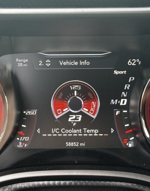

Temps that low always worried me. Iron vs aluminum heat expansion rates and what not.

That was just showing how good it chilled is all while driving around the other day

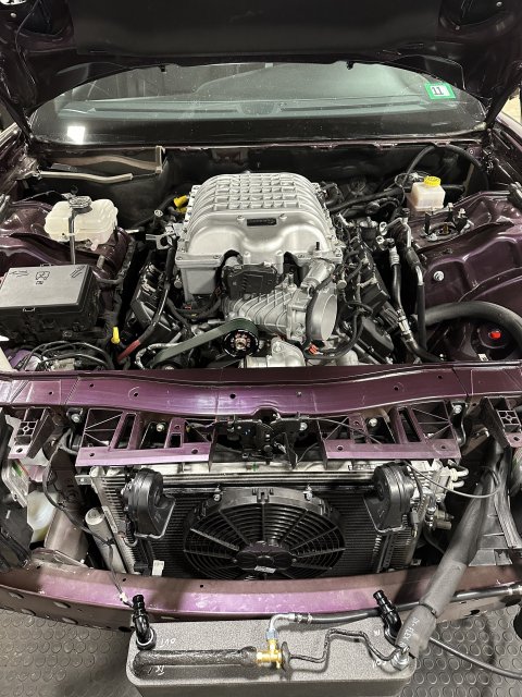

Finally got the hater maker special stuffed into the engine bay. We’re close, folks. Thanks to anyone who has stuck around. This has been a serious test of my mental health. :ROFLMAO:

Transmission now in. Shop is/has been short handed so they're trying to chip away at this as much as they can. Fabricating the water tank for the FI Interchiller system today and will then get that installed. I imagine after that it's probably just some exhaust work and we're done. Hoped to pick up this week but feel like that may be a long shot.
