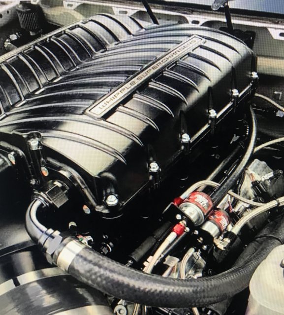

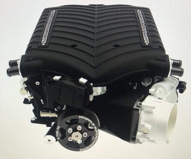

AAF45C62-B71D-4205-A879-9CC5C999A350.jpeg 5932B5B4-74AE-439F-B6D0-86412923D89C.jpeg That’s the old one. New one is a completely different animal.

A couple things to know about the new 3.0 Whipple ready to hit the market. 1..... don’t confuse it with the 3.0 DragPak version. There are obviously some differences. The plenum volume on the old 4.5 was extremely compromised (as is performance) in order to fit under the stock hood. That was a marketing decision that was made because it’s hard to sell something that requires you cut or replace the stock hood on the car. Looking at the DragPak version it looks big. Comparing the pictures of those with the ones just released of the new street version, it looks like the volume under the lid may have been reduced some as well. The shape is different and the IC plumbing is different. So basically..... I wouldn’t expect the street 3.0 being released now to have the capabilities of that DragPak (it will fit under the hood however). Inquires by myself and others about using the DragPak 3.0 on our Hellcats ended up with us being told that it can not be done using the OE electronics. The throttle body is manual and a stand alone tuner (Holly EFI) needs to replace the PCM. Personally, I think this new Whipple will doom the modded IHI as the choice for increased performance over stock. Time to sell those while they’re still worth something 😂 27C8E8A4-FFFB-432E-872A-5F9F3C4DEB7F.jpeg 80EFBD6A-E219-449C-9C01-6EB4EA1F1231.jpeg

I just saw a post on Instagram of one of the DragPak 3.0 superchargers being installed. It does not fit under the stock Hellcat hood. They were cutting the underside of the hood in the rear to make room. The new street 3.0 about to hit the market is certainly compromised in volume up top to make it work under the hood. So one shouldn’t hope for the DragPak level of performance out of the street version. Whipple has already stated that the new 3.8 when it comes out is just for big stroker motors looking for max hp. There’s no way that description is fitting under the stock hood!

The Dragpak 3.0 will fit under a Hellcat Hood with mods. The DP 3.0 realistically has the capacity for just under 2000 HP out of the box. The 3.8 will be more around 2500HP worth of airflow. I can tell you that the difference between the IHI 2.7 and the Whipple 3.0 was roughly 200 WHP and about 7.5 lbs more boost. The production Whipple 3.0 indeed has the same rotor group as the race blower I fully expect to crack the 1100 WHP range on a 6.2 pretty easily in the Demon.
Hope this helps
