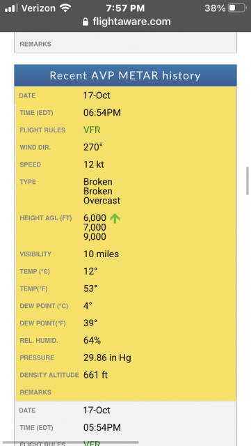

Here is your run at seal level (0DA)
ET (1/4):MPH (1/4):DA :
Your Run:ET - 10.149MPH - 137.37
Corrected MSA:ET - 9.75MPH - 142.91​
Seems about right for your mods and weight. My 2019 NB Redeye full weight was about 4750# with me in, I weigh 320.
Lots of cool auto calculators here. You can also calculate ET change if ditch some weight.

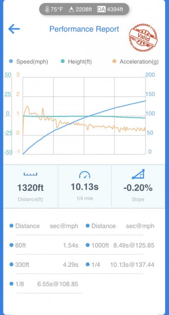

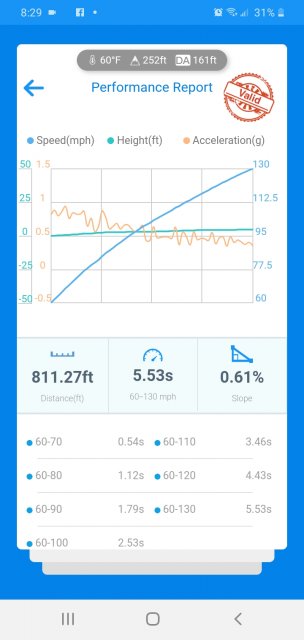

My DA playing around the other night:
Here is my dragy capture for the run. It seems my acceleration drops off quicker than yours...
High iats. Computer pulling timing to save itself.

I found some great track prep a couple weeks back and the car was able to launch under full power @ 2000 rpm in first gear. The feeling of hooking up that hard is an adrenaline rush that is going to be hard to beat!
I am still scratching my head at the timeslip though. The DA was terrible (4500+) and I am still full weight (plus my fat ass) but I feel like that 9 sec slip should be easily possible at this level. I am beginning to wonder if the trans has issues as I can't find any other reason for the times.
Any advice from the pro's? ;)

Like everybody else has said, 4500 DA is the only thing holding you back from mid 9's compared to sea level & 0 or negative DA.
Be careful though going from high altitude tune to sea level without getting it tuned for low altitude, bad things can happen.
