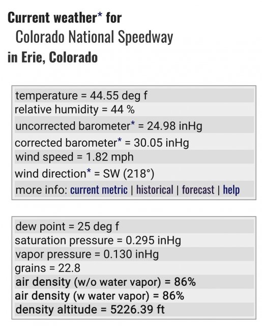

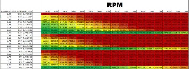

The log doesn't look near as bad as I thought in terms of air charge temp. Yours got to like 153°F which is about where mine ends up when the weather is hot out. I've seen as high as 164 or so if I have to hot lap and I'm on a 2.72 pulley. I do think the 2.5 spins the blower a bit too hard so if you continue to run it, I'd have a plan for bearings etc in the shorter term just in case.
I think the DA is what's holding you back like I think I mentioned before. Every +1,000 foot of DA is worth about 1/10 on ET and probably 1MPH as well. You were at 4500, so that's 4/10 and 4MPH by rough estimate.
Here's the blower efficiency data I have. I think HPindy may have first posted this?

If the interchiller controls the high IATs and allows me to take advantage of the extra boost by keeping the car from pulling timing then I am all for it!
Sounds like the interchiller and a future snout upgrade (port and bearing) is probably the right path here...
