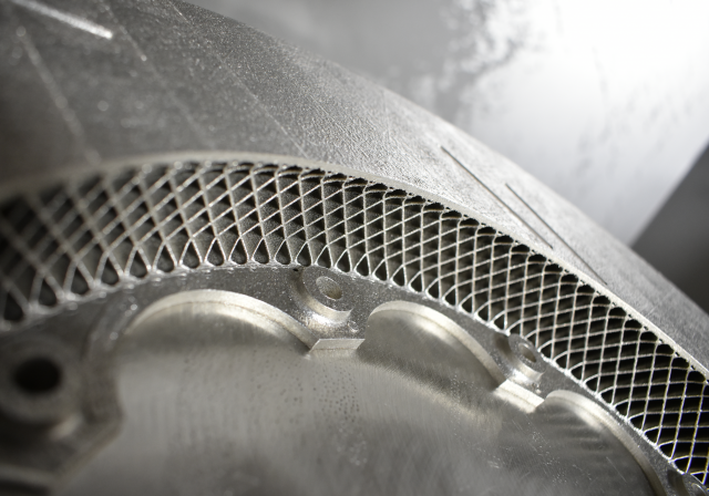

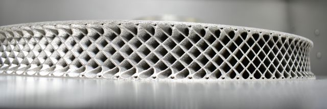

As promised... (Still on the build plate)
Inconel ~12.5lbs

Proprietary E3D MMC Inconel 625R2 and/or Inconel718, there are subtle pros and cons to each, but both are excellent materials for this application, and are both qualified DMLS materials.
