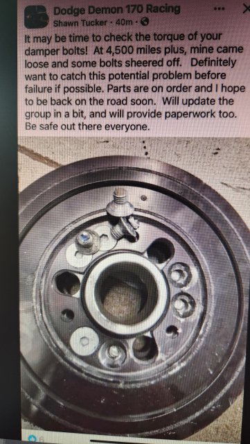

@Speedy! Crank pulley recall for the 170? If only they pinned them..
Well, that's certainly a mistake also, but pinning won't stop the bolts from backing out on the back side of the pulley... someone forgot to use loctite I guess.

Wouldn’t stop it but less chance of damage, if the bolt backs out it’ll spin on the crank

4,078
Yep it should have been pinned and set with loctight.

Rumor is a new crank pulley design is being tested. I'd think the 170 crank pulley is the same as all other Hellcats so why the issue?
That is definitely not the same damper as the HC.
My understanding is that it's the new part made by Fluidampr.

The 170 is an actual fluid dampener unlike hellcats and redeyes, or so they say

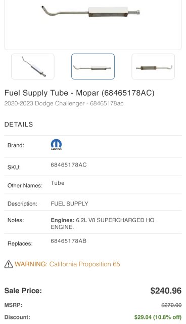

I've looked it over pretty good and other than a "voltage stabilizer" that's in the trunk by the FPDMs, the only other thing I see different is some kind of box the fuel line runs through on the passenger side. At first I thought it was a filter, but it doesn't appear to be serviceable. Someone suggested it's some kind of cooler? I'm also not sure this is unique to the 170, might be on other 2023 models.
Could definitely be a fuel cooler. Cooler fuel = more power. Wonder if anyone found out what it is yet. It also appears to be a thing on all 2023+. Just ordered the redeye/superstock/demon 18-22 main fuel line, and it’s not made for this, but that part says it fits regular hellcats as well 2023+
8,762
7,687
Expensive little bugger

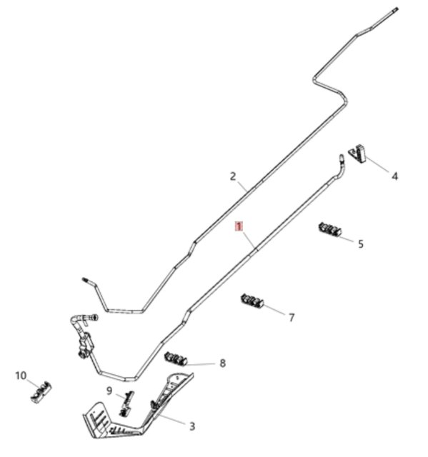

I ordered this, which “should” not use that, but has the flexible fuel “jumper” to the rail built into the actual hardline
