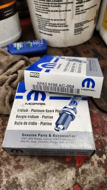

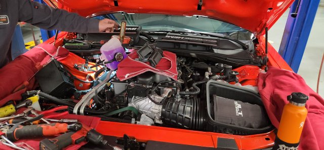

Had the spark plug bulletin performed on Otis. Original Champion plugs were all right at .032". New Champion plug (same P/N) were gapped to .024". My buddy head tech at the dealer did the job and said it was a PITA on the passenger side and that the book time of 1.7 hours was BS if the job is done right and carefully. I checked on him about half way through and he was using a digital torque wrench to torque the plugs to 22 ft/lbs. He's meticulous.
I bought him a nice bottle of whisky.

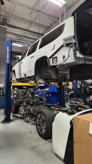

There was a new Jeep Grand Wagoneer on the lift next to his.....needed the inline 6 TT motor replaced and the ENTIRE BODY had to come off to do it. YIKES!
Now It's sounding like a crank damper recall may be coming due to bolts backing out. I asked him to check mine and he said from what he could see it all looked fine so fingers crossed.

The body has to come off?!? That’s nuts!
All modern trucks are built this way, even the rams

I guess I didn’t realize the wagoneer was full frame
