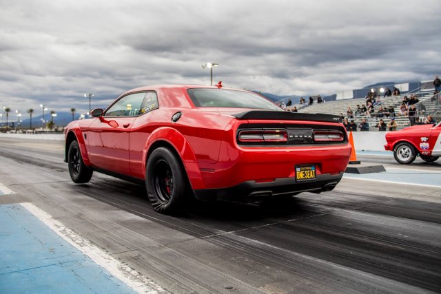

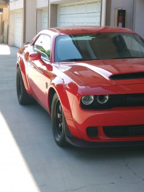

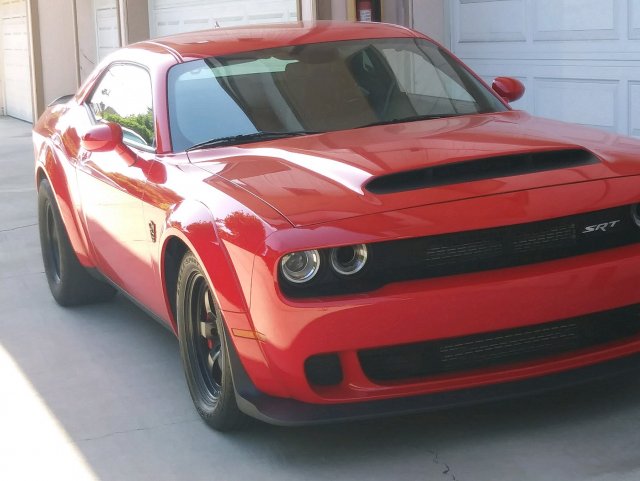

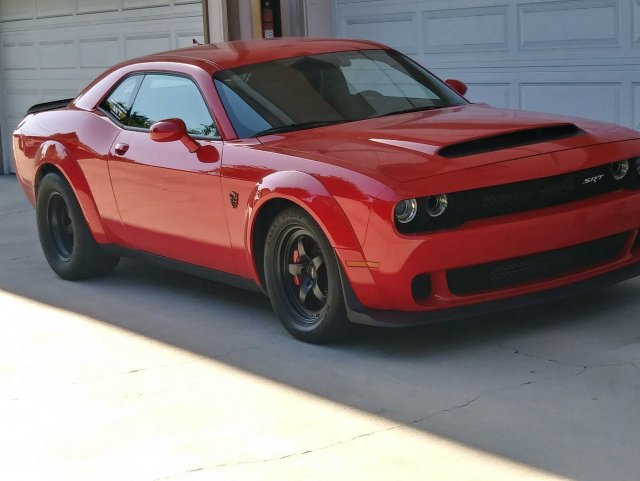

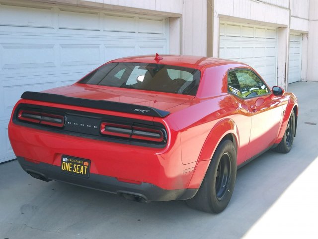

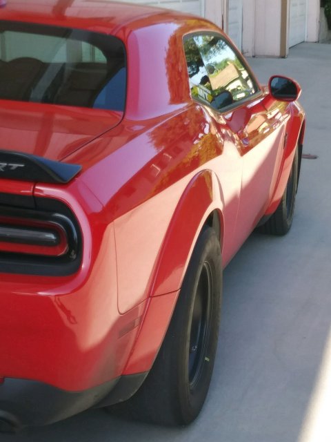

I have run that exact tire on my Demon on a 18X6 wheel. In fact it is the same weight as the Mickey Thompson Sportsman SR skinny (which is heavy for a Skinny). But the Goodyear will 100% drive better. I have driven BOTH setups because my Friend stretched the Sportsman Skinny on the very same rims and I drove his Demon to get rid of fuel so he could blend his octane up to 100 to run the 840 mode. He told me to drive it like I stold it. I like the Goodyears much better.

Dang thanks for that info. Don't make any special effort, or any effort at all if you don't feel like it, but if you happen to think about it at some point snap a photo from the front, maybe off to the side just a hair so I can get a better idea of how much the sidewall bulges out and I will try to picture it on a NB. And maybe a couple more but no big deal. Thanks again. EDIT and great photos BTW

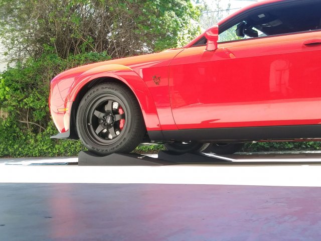

Great photos and info. I appreciate you taking the time for this. I see these Goodyears have over a 500 treadwear rating if I remember right so they must be somewhat hard, but obviously you don't have any trouble stopping or anything else. I need to find the weight, and offset of the typical NB Alumistars and then do what you suggest, and that is picture them on an NB. One more question....Would your S-71 18 x 6 fit over the large 6 piston Brembos ? Seems to me they won't . Reason I ask is that I that have S71s 18 x 10 with black centers in the rear. Thanks

They will not fit a Hellcat. I have been 140 mph on them at the drag strip and they drive really well on the street. That is in fact my street setup. I sold my OEM Demon wheels and tires a while ago.

I found out that the Alumistars are 2.7" BS. Looking at your car, and taking into consideration that the Alumistars will be outward .4" more, plus considering that the sidewall will bulge about 1.5" on each size being they are advertised at having a 9" section width, I am really not sure how they would appear on a NB with the 225/60's. I need to see a NB with that setup which probably aint gonna happen.
So I have a question. Are your front brakes and rotors the same as the 08-14 SRT's ? My '09 stops fine from any speed, and the conversion is simple plus I already have a set of 4 piston calipers. Steve White sent me the entire changeover list and links to the parts. I could run 18" S71s all the way around and paint them black like yours. And use the 28.6" tall 225/60's up front on an 8" wheel. What do you think ? Oh get this, as a side note, my tire would always slip on the wheel somewhat and I see people using hi-tack and what not and they still slip. I just deal with it and beadlocks are not in the plan right now. So some old geezer told me to use molasses and swears by it....He said back in the day that was the answer. I thought to myself that was when top fuelers were running 10's lol But I might give it a try and if it screws up I won't tell anyone lol
