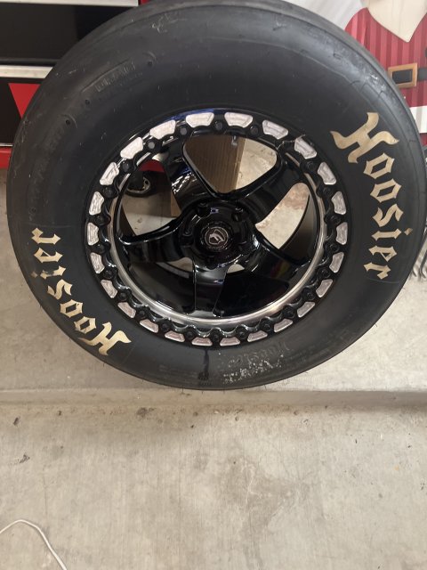

I'm looking at my Hoosier that has been sitting around for three years. It is 29.5 inches tall and without a spacer it was hitting a little on hard throttle response at the strip. So when I do buy new ones maybe I'll stay away from the 30.4 mickeys.
