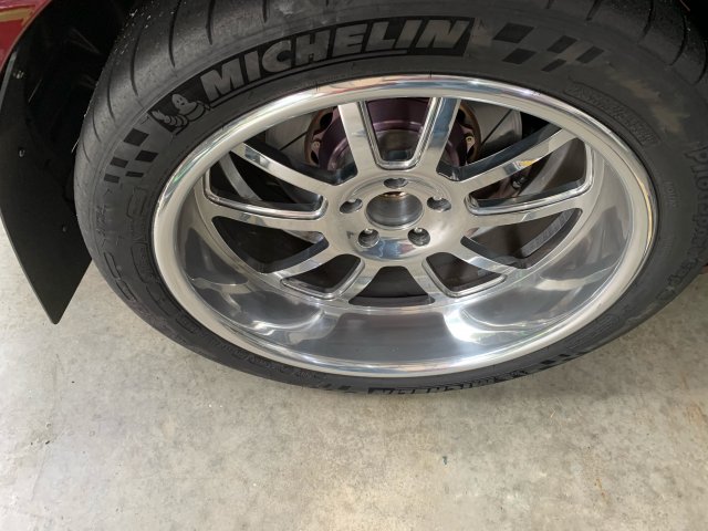

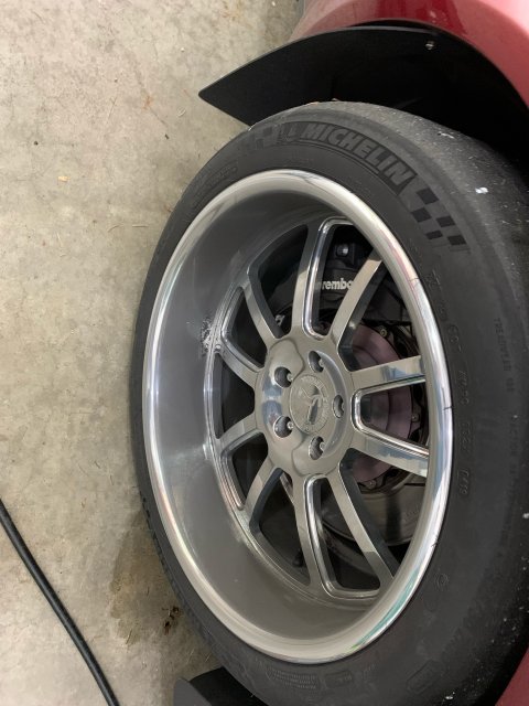

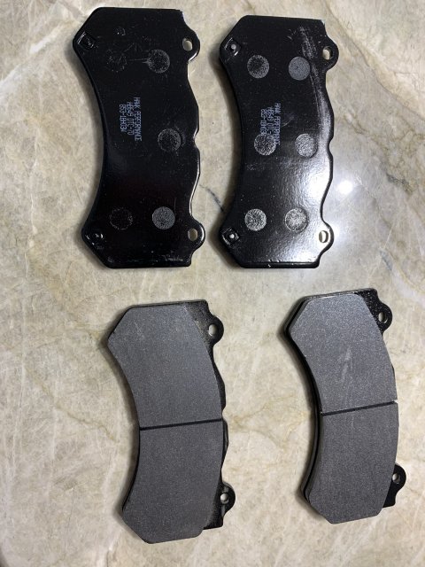

DGatzby, in your experience (and given that I have none) how much remaining brake pad is safe before a two day HPDE weekend?
A new set, and a spare set. This road race stuff is not easy on the pocket.
Those Brembo pads had a half day remaining. They suck, they were worn crooked also, we have seen that before.
Speedlogix has a good line on the product, so she was able to help me overnight. The debris on the front wheels after I scraped the Brembo shit and bedded the Hawk was amazing. The rears could give a rip.
Front
Rear

Brake pad wear will depend heavily on how hard you use your brakes and that will depend on the driving style and track design. A front set of DTC70 pads will only last me 3 sessions at Road America but I'll get at least 1 more session out of them at Brainerd.
It's pad taper that killed my pad life this year. The pads don't wear evenly front to rear of each pad due to caliper flex under high load.
Wesley should have a Viper caliper adapter available this Fall. The Viper calipers are more resistant to flex and have tapered piston diameters front to rear. Without a taper concern I could probably come close to doubling my pad life.
Many people will rotate their pads during a track day to get more life. That's more work than I want to devote. I need to at least make a full day so I can change or rotate my pads after it's all over.

Dang! is that your cup2 up front? and comparing it to the cup2 in the rear?
We've got to do something about that for you. Once again... not enough negative camber up front...
We all know how these cars understeer... Another thing to do is change the balance of the stabilizer bars. See if you can get the car into more of a neutral balance or one of a happy tail balance. Loosen/soften up the front (i know counter intuitive) and stiffen up the rear. This will force some of the weight transfer onto both side tires and to get it to rotate around a center axis instead of just one side tire and an axis that is not near the center of the car.
Another thing to consider unfortunately is driver input. I mean, lets face it... none of us are pro race drivers... that's why when the coach/instructor drives our car, it does all kinds of things for them it never seems to do for us.
Even with a perfect setup, a jerky turn-in... or just unsmooth (is that a word?) driver can throw the car and upset the suspension such that it's simply not going to make the turn... or it's going to make it, but it's going to make it and complain the whole way.
Do you have a way to look at data from your runs? Something that would provide running data for steering angle input? Something like a Solo2DL, or similar product, could tell you where you are on the track, and amongst a billion other datapoints, tell you steering angle. Viewing that in graphical format would show us if it's spikey or nice and linear.
Just some random thoughts that I hope you dont mind.

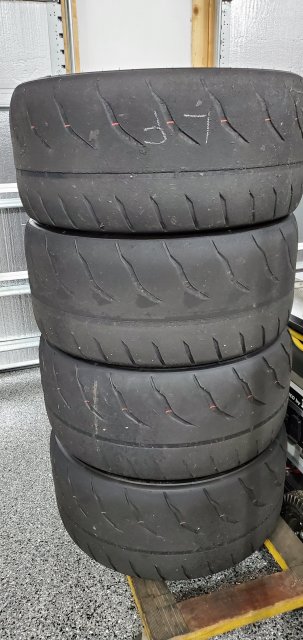

Here are my tires after 5 track days and less than 1000 street miles if memory serves correctly. From top to bottom
Driver Front
Driver Rear
Passenger Front
Passenger Rear
My Driver Rear is the most heavily worn which makes sense in that most corners on CW tracks will be right turns and I'm usually pretty aggressive at coming out of corners. The other 3 tires are wearing pretty similarly and probably had 1 more track day in them. My Driver Rear was starting to delaminate.
These are 305/35 R888R on all 4s with 10.5 front and 11 rear wheels. MP springs with a Hotchkis front bar.

We will see. A Hawk never went that tapered on me, I drove four sessions. Plus they just did not work with a shit all day. I cannot believe how much more solid the DTC-70’s feel. Good news on upcoming brake products!
