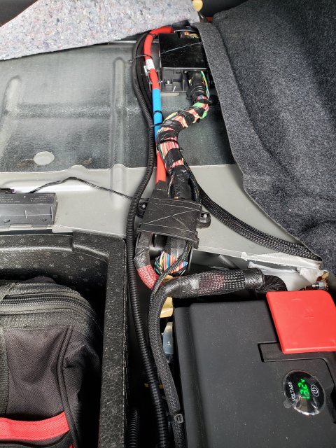

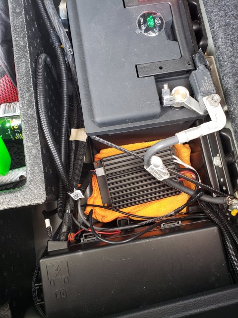

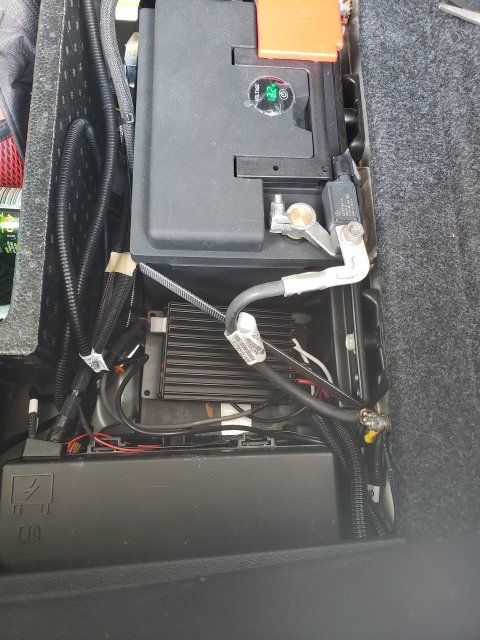

Jon and I installed the JMS BAP Powermax P2020PPD18 yesterday. Instruction are for a Mustang so some stuff isn't needed. It is a plug and play for duel pumps. There is a long wire we ran up the passenger side to the front and over to the pedal. Unplug foot pedal connector and there is a Y harness that plugs and connects it all. There are 2 more Y harnesses that come out of the BAP that plug into each fuel pump fpdm modules behind the right side panel in the trunk. Then there is a ground wire which we found the eye was too small to hook up to the grounding post so cut it off and installed a bigger one.
There are 5 switches on the BAP and it tells you how to set it up. For some reason when we turned the power off the pumps kept running. We tried multiple thing but it kept doing it and we had to disconnect battery. We unplugged the connectors off the fpdm modules and reconnected them back up and then it worked right. One of the harness has red wires that come out and the other has white that come out of the BAP maybe they need to go a certain way and we happened to reverse them.
We went out and did a datalog and it is holding pressure at shift point now at 80 psi so we know it is working
Jon already had one on his car when he got it so was able to reference it some. He has a stock size battery and it is tucked in front of it. Mine is shorter so I went behind it. It really doesn't move much so either are not mounted. I put a towel under it so it will not be bouncing on metal
