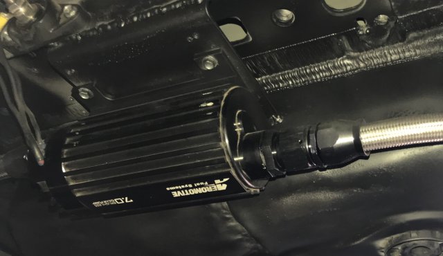

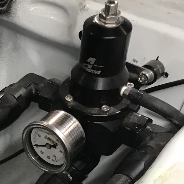

With what you’re spraying, you have to be on crack for sure! Do you think that 3+3 setup increases your failure potential just in numbers? Would it be possible for a setup like yours to ditch the BAP’s and go with a stand alone external pump separate for the nitrous? I’m not a nitrous knowledgeable guy (it scares me šŸ˜‚). I’m using the Aeromotive brushless external (7gpm) that covers my fuel needs with the single pump and 2200cc injectors. If I ever added a substantial amount of spray, I’m guessing I would need to step up the 10gpm big brother. These things make the Fore pumps look cheep so that’s a good reason not to do that. 2DF49DF8-4F73-43F7-9C53-7328F3768D4B.jpeg 2AD3E651-FEFA-47D6-86BD-45BDDB15EB16.jpeg

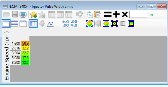

These Hellcats aren't "normal" cars. They're actually quite clever particularly when it comes to fueling. There's a table in the tune that monitors injector pulse width (the amount of time in milliseconds an injector is "open" and spraying fuel). In a nutshell the car is programmed to a specific amount of fueling and the fuel pressure and injectors work together to meet that commanded fuel. If fuel pressure starts to drop, the injectors will stay open longer (more milliseconds) to maintain commanded fueling. If that injector "open" time gets too long the bypass opens and bleeds boost. This is why you see people have problems when they try to run these cars too low on fuel. Same thing happens.
Data from a 2020 Redeye. Factory limits on injector pulse width. At upper RPM it's 13.7ms.
Interestingly, the Redeyes use the same pumps as a standard Hellcat as far as I know. The difference is the Redeye has two pumps instead of one. They're 285 liter per hour pumps. In a Hellcats and Redeyes the fuel pressure is variable and max commanded fuel pressure is 80psi for Hellcat but in a Redeye it's a whopping 100psi. That's crazy to me as my old car was 58psi. You can bump up commanded fuel pressure in a standard Hellcat but due to the passenger side venturi it won't get to 100psi like a Redeye. I've also learned fuel pressure and fuel flow are related. More pressure less flow so it's a give and take.

That functionality is bugged for most 2018-2020 MY vehicles and doesn’t work as it should like in 2015-2017 vehicles. Very unfortunate as not having proper boost bleed safety significantly adds more risk of hurting the motor when injectors go 100% and beyond due to fuel system issues or inadequacy.
