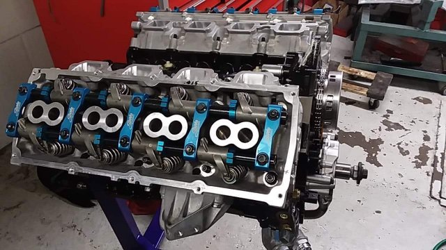

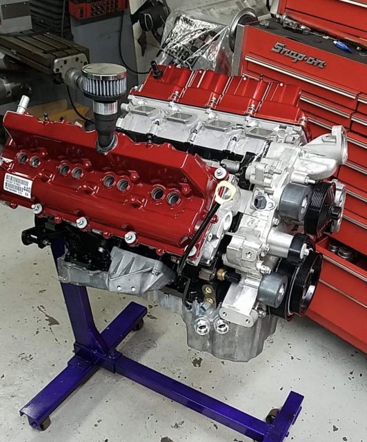

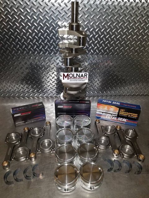

It’s been a long 4 months but the car is nearing completion. For those that didn’t see my thread in the other forum, my stock blower grenaded and shrapnel took out my motor with it.
My initial intent was to rebuild the stock motor but after a lot of time, thought and some opportunity, it became sort of an all-out build. Here are some of the details:

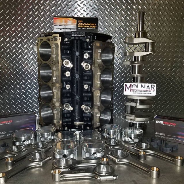

ENGINE:
-426 stroker (technically 428)
-Molnar Crank
-Molnar Pwr Adder Rods
-Custom RaceTec pistons (10:1 for E85)

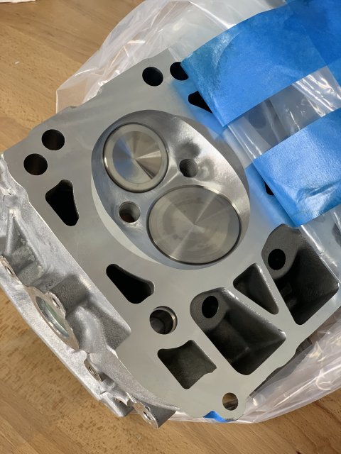

-HC Ported Thitek heads with upgraded springs (A big thanks to @WhipCat for these!)
-All ARP studs throughout
-Stanke rocker arm set
-Custom Johnson lifters and Smith Bros pushrods
TUNING:
- @curt_dusterhofftuning
FUEL: E85
-ID1300 injectors
-IE Gasohol dual pumps
-JMS Powermax Dual BAP

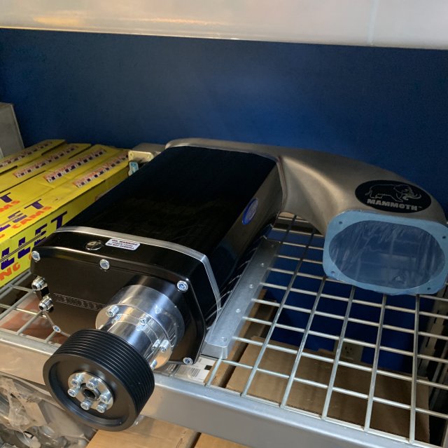

S/C:
-Kenne Bell 4.2L with 170mm Mammoth TB

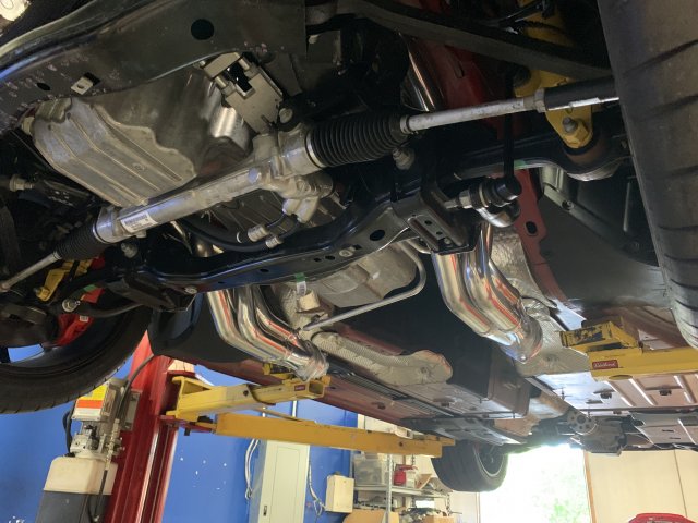

EXHAUST:
-Kooks 2” Headers w/Jet Hot coating
-Kooks catless pipes to stock catback
TRANS:

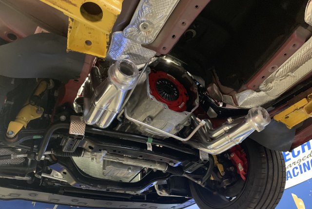

-Stock M6 (for now)
-McLeod RXT 1200 Clutch
DRIVELINE/REAR:
-DSS Alum Driveshaft
-P4D DIRS
-BMR cradle bushings
-BMR Diff lockout
-Spohn upper/lower/trailing arms
-BMR toe rods
The car is currently undergoing the transplant so I will update as this progresses but here’s some pics from the build.

Marc- Kenne Bell was running a really good sale a while back so I ordered one expecting to stay with stock displacement at that time. Combined with my power goals of upper 900s to 1000ish at the tire. That’s still the case with this motor so I think the 4.2L will be a good fit.
I’m way over built compared to what the motor can handle but I wanted a lot of safety margin and room to grow if needed. For now, I want to keep a manual in it and that’s the reason for keeping the power low. I’ll likely enjoy it for this fall and then have RPM transmissions build it to their Level 7 this winter. This car is a weekend toy for me and its going to be about 70% street and 30% track use..... I really enjoy driving a manual so I’ll try it for awhile and adapt if I have to in the future and then turn it up![wrenchin]
