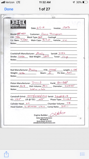

I’m sure you’ll get there! Just be careful with RPM on the stock blowers. Seeming to be a killer on these things. I’ve had a few people reach out to me with the same issue and they were spinning them up to 6800 and even 7000 when they let go.
I wasn’t logging when mine when it went but I try to shift at 6200, though I have a tendency of no lift shifting, I’m thinking that was the case and probably revved up enough to over spin it

This is my build sheet. Shift point is at 6400 rpm I believe. Tim Barth is the tuner.

Lol this is mostly a street set up so I really don’t need any mor HP. I need more air so I gotta upgrade my SC next summer.

My engine builder Alex at BBP was surprised to see those numbers in that heat index on a stock blower.
I’m tempted to order a KB SC right now... lol
