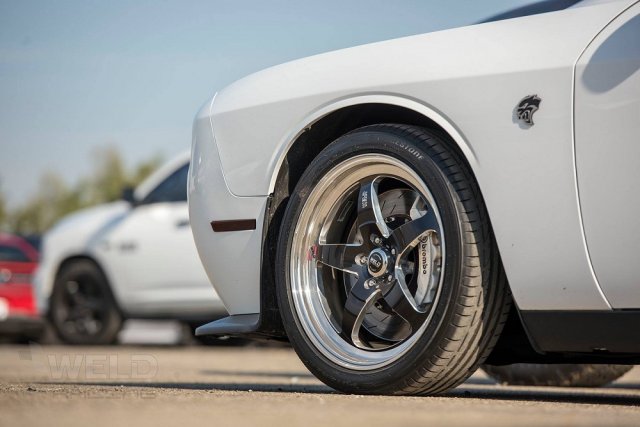

Found this pic on the ol' webz. Can't make out the details on the sidewall other than it's a Bridgestone Potenza.

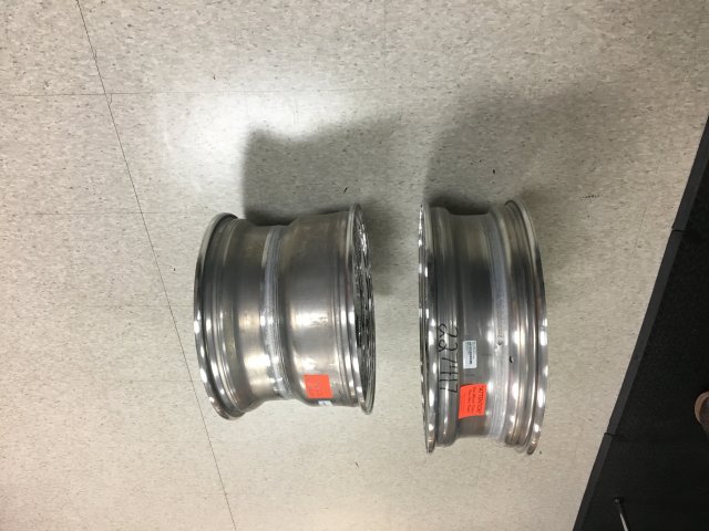

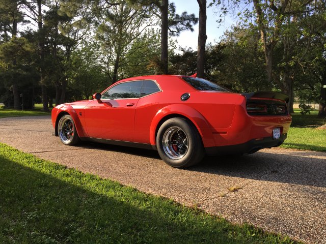

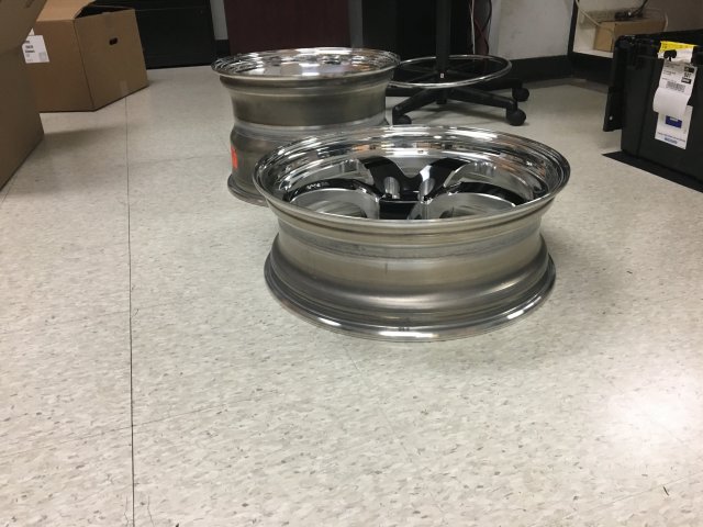

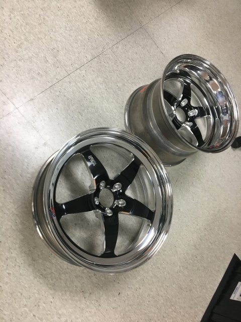

37A2A214-6605-4BF5-A489-D3B7AAC38AD0.jpeg 1AE1B982-5E82-461F-B820-A84FEDCB005F.jpeg C1B31D02-7445-4980-8E77-EDF7BF204DCF.jpeg
20,157
son of bitch, that's pretty.
