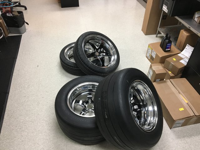

M/T 315/50/17 ETRs in the back. I just ordered one Bridgestone Potenza S001-I in 195/50R20 sizing. I think it will fit well. Its damn expensive, but whaddya do lol. But, it's a max perf summer tire, has a XL load rating and is speed-rated to 168 (basically what a DR is speed rated for).
We'll see.

Got the TPMS sensors and tires installed. Front tires fit great, no issues there at all. They also balanced very well.
The backs I had a hard time with. The Hunter machine keeps kicking up an alert of “bent wheel”. I can also see noticeable wobble on the back side of the wheel when spinning it. One wheel/tire called for 1.75 oz and the other one called for 6.25 in one spot and 3.5 in another. I really don’t know what to make of it. I really doubt I got 2 bent wheels from Weld...I’m leaning toward ls there being an issue with the balance machine. Either the machine itself or the way the mounts are being used. I’m gonna look for a place here in Houston that has experience balancing these things.

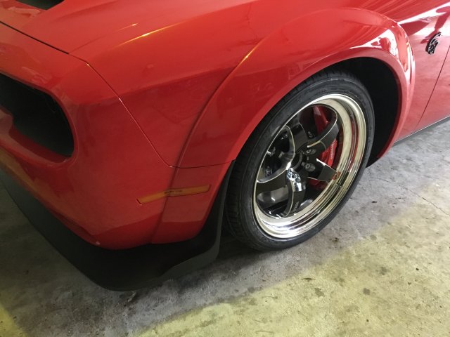

Gonna need longer front studs
20,154
Looks tight on the calipers, but I know its not. Nicely done - looks great. People will start watching out for that car.

Thread Starter #30
Oh yes, it is tight on the caliper. Weld specified a 3mm spacer which I bought from ZL1addons and it barely clears.
It was way overpriced for a spacer but it looked less like an afterthought part than any others I saw.
