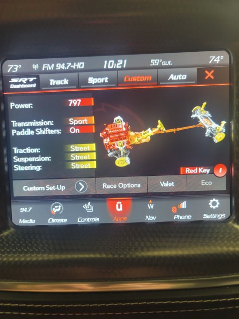

With street tires I have been told the problem is that the tires are spinning and the computer has no parameters for that condition, so there is a lag in the shift.
But I'm running M/T 305 45x17 at 18 psi on a prepped track. I cannot tell if they are spinning after leaving the line. My best 60 ft is 1.51. I am still trying out different settings for my custom mode. I am getting some wheel hop occasionally that I cannot figure out and I have the DIRS diff support. M/T reps said to increase my tire pressure to 20 lbs but I have not been to the track since to try that out.
Jon-MooredPerformanceLLC
#12838
340
1,210
Martin
2018 Dodge Challenger Hellcat
#56
If you are getting hop that is a good sign to increase tire pressure. Many members on here run over 20psi. If you are on really good prep then yes 20 to 21 psi. If I was you try the 19.5 - 20 range to start and adjust from there.
As for custom settings
trans track
suspension street
traction sport
Oops....that picture was my street custom setting. My dragstrip settings are:
Trans - track
paddle - on
traction - sport
susp - street
steering - street
