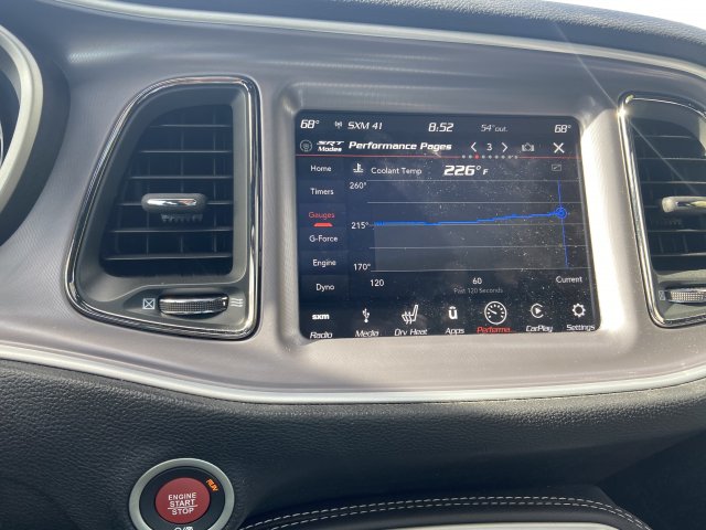

This is the crap that makes me wonder...

Year, make and model.

2019 hellcat redeye wide body.
Does this on cold start then settles down.

^^^I don't look at that screen hardly ever, but something definitely does not look right, especially if that's on a cold start, I mean there's no way the coolant is up there right after a cold start.

My RE does the same exact BS the first time it warms up. Exactly like that. Now, this is interesting. Eric and @Paladin06 are you guys saying your Redeye's don't do that? Because his RE and mine just both upchucked the SC pulley, but neither of yours did.

Just so I understand, so car was driven, shut off, then restarted with a lot of leftover heat in it? Or it says this on a cold start - which has to be an instrument error then - right?

I’ve never seen 226 degrees at any time. Even on the dead of our 115 degree summers.🥵

It takes about ten minutes of driving to hit this temp.
After that it settles down to 200-205
I didn't ever look at the performance pages til I saw my temp jump like this and then started to monitor it
only does it when the car has completely cooled down

Oh ok I see. That is not an error, I don't remember our stock tune fan settings, but that's about the top end of normal for our car's coolant temperatures with the stock tstat/tune/fan settings, so you do not have a problem. When you are driving and air is passing through the car, that number should go back below 215 pretty quick, especially in those outdoor temperatures in the 60s.

It drops right down, I will take a pic of that screen some time.
Goes down in a few seconds.
Yeah cool. The car may just initially get up there on the first driving cycle before all the cooling fans kick in and keep it from getting back up there unless you are pushing the motor hard.
