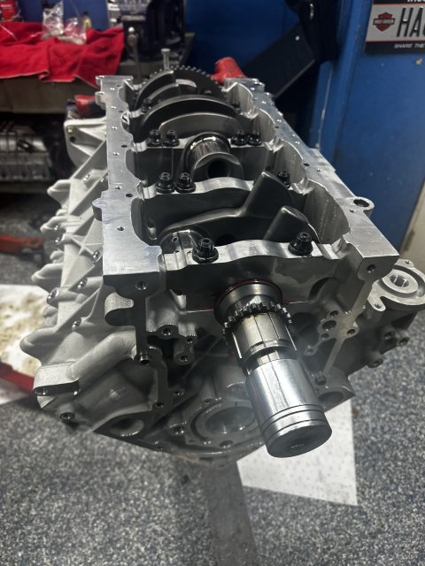

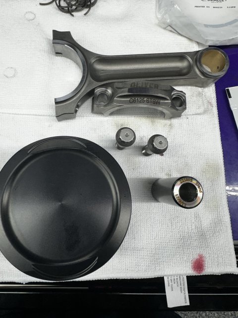

crank is in .002 main bearing clearance. Bolts tq to 80 foot pounds. Cross bolts to 25 rings are filed to .029.
this is fitted with a Winburg crank.
TNREDEYE
#1211
1,000
2,520
Shelbyville
2021 Super Stock
That's a nice looking pile of parts. (y)
4,381
10,904
Wait a minute here that doesn't look like a stock 6.2 :unsure:
8,520
7,452
It’s Al-lu-mini-um

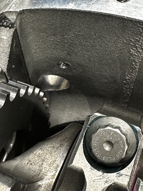

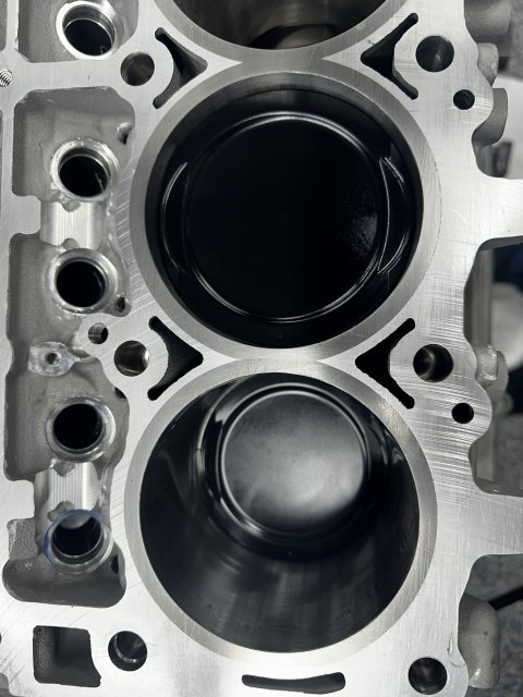

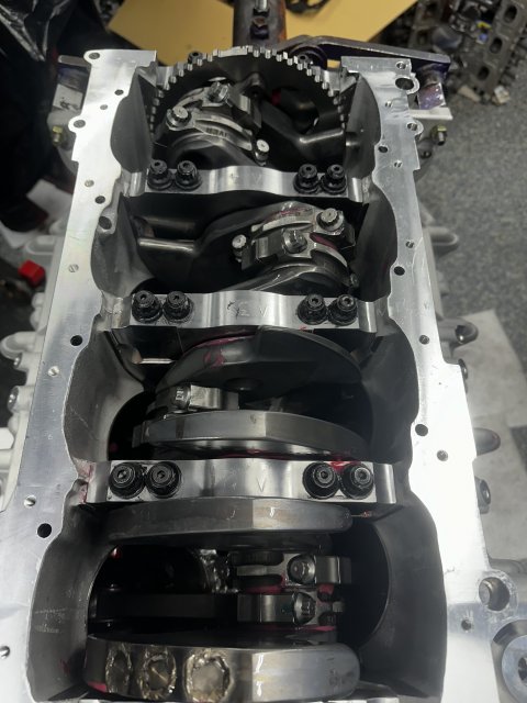

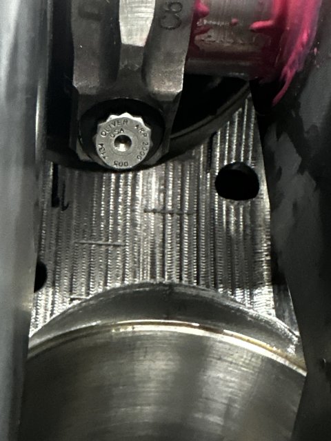

Christmas Morning time to do my shit.💩. Got my short block done not fun having to grind on a 7500 dollar block so rods clear cam tunnel. But it’s done

Looking good! Did you have to grind the bottom of the bores for the rods??

That’s crazy! Didnt have to take anything out of the sleeves though?
Nope.
It's not uncommon with custom bore and stroke combos or camshafts with cylinder heads.
