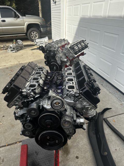

Well more winter fun. Need to make sure friends hit their goals also. IMG_7422.jpeg
