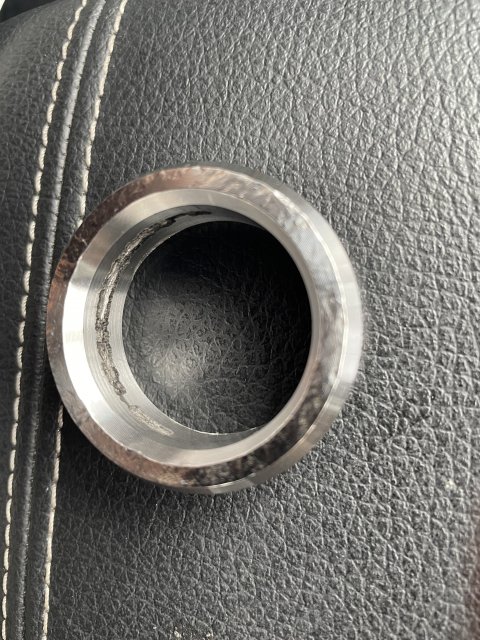

Whenever that particular ground to the bell housing isn't secure, the trans may try to ground itself through the converter galling the pilot bushing that the converter slides into. Often when this happens, the converter will stay stuck to the engine when puling the trans off. I've had to replace a few pilot bushings and smooth out the converter end a couple times because of this.
I don't know how long it was like this but it came to a head yesterday.
Hopefully no other issues and hopefully no jacked up pilot bearing. Guess I won't know til we yank the motor/trans again.
Jesus, how many amps are pulling through there to weld the bushing?
I dunno, but here’s what it looks like when you forget to secure that one ground to the bell housing. No apparent issues besides being surprised, disappointed, and a oiley mess whenever pulling the trans and the converter stays on the crank. IMG_4664.jpeg
