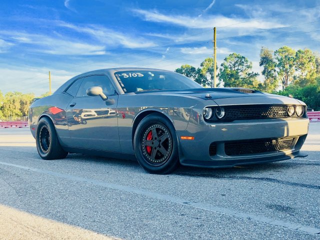

I swapped over. Helped a little bit. Still can’t get my 60’ to drop under 1.45
I keep blowing the tires on the hit. I got to try taking power out of it on launch.

I can actually see the negative camber you've got in the rear in that picture. Go positive and you'll do better.
Nice picture btw.... Looking forward to GB!
WhipCat
#985
1,500
3,871
In the Jungle
Yep. We will be getting an alignment done for the this wheel and tire combo next week.
Appreciate the heads up.

Bad ass looking car. What wheels are those?

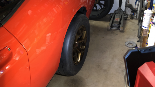

Is there any chance of a damaged fender on a NB Challenger/Redeye with the 315's when the rear squats, or hits a large bump ? What wheel width, offset and/or back space is recommended for those tires? And as a side question while I am here with you gurus would the 1320 springs be adequate for a redeye or forget those and go with the Demon knock offs ? Thanks
