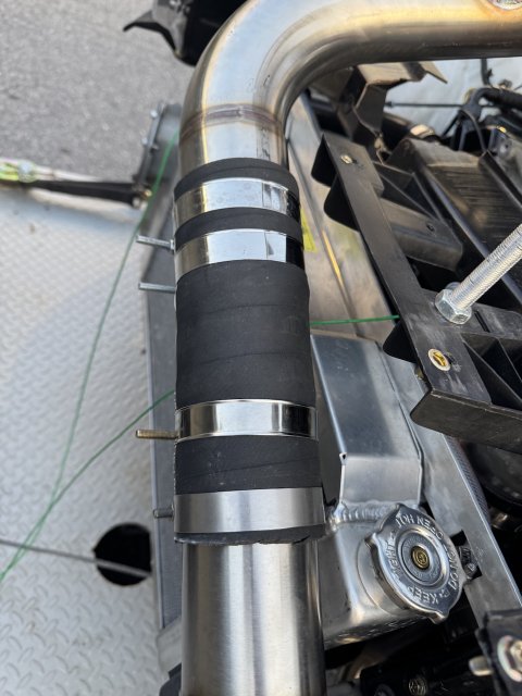

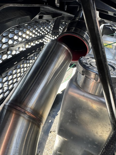

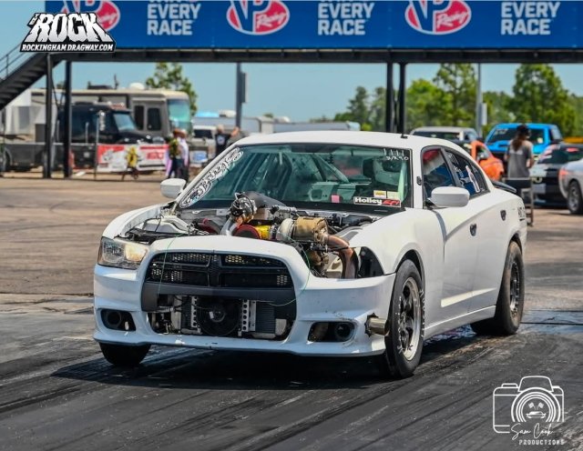

Had a shit ass time at Cecil doing licensing passes, fuck that noise. Also kept blowing couplers off.
IMG_9363.jpeg The fix...
IMG_9364.jpeg Learning so much at the track. How to launch a car on the Holley. Left suspension alone, pulled some timing at launch and she was making some power. Still hitting boost cut. New setup though so we out here testing.

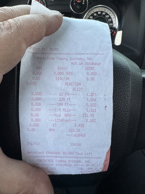

Just curious, what is the DA on these passes?
RGPIII
7 Second Best E/T
  • Apr 11 6:00 pm
  • 69 deg F
  • 36%
  • 30.15 Hg
  • 41 deg F
  • 37.5
  • 4 mph
  • NW (345)
  • 98.222 %
  • 613 ft.

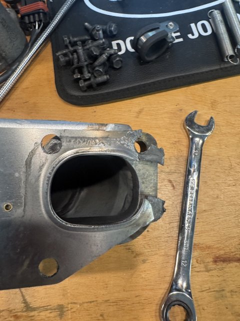

car weighed 3915 this weekend and was on rails till it wasnt. Blew both exhaust manifolds. Kelltrac suspension was put through its paces. @RGPIII gave me some settings and it dead hooked every time.

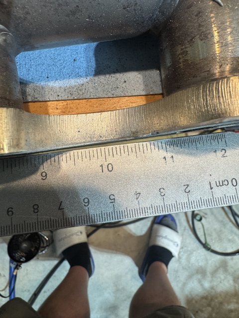

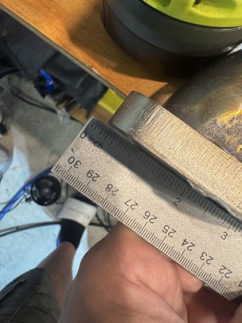

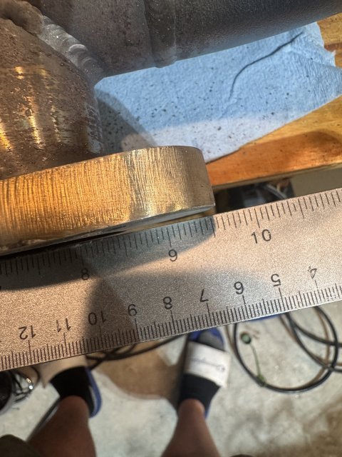

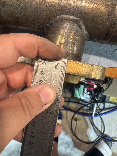

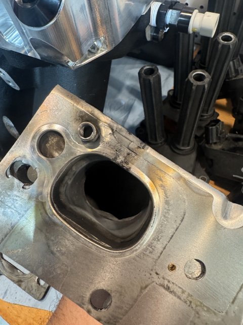

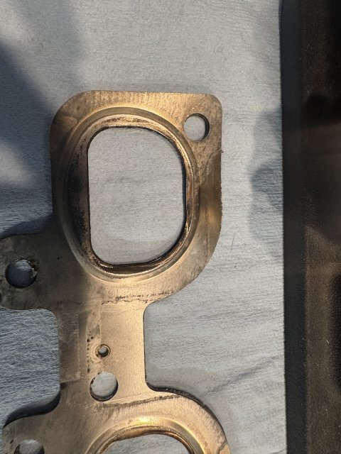

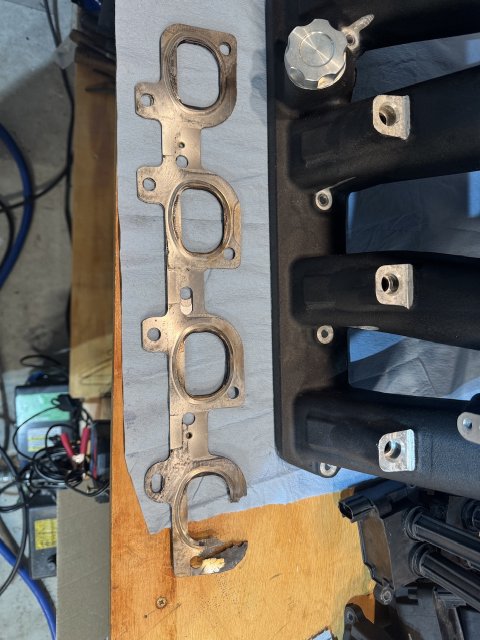

The flanges warped, and the manifolds said weeeee! The kit was a good experiment.
IMG_9756.jpeg IMG_9755.jpeg IMG_9752.jpeg IMG_9749.jpeg IMG_9750.jpeg IMG_9751.jpeg IMG_9754.jpeg IMG_9753.jpeg
We are moving forward with getting the car sent down to BPF. Twins loading. The is the last photo youll see of the car this way. New hood and bumper ordered. New turbos 73/89 and no pictures till its finished.

That's crazy! I'd have them warranty to manifold at least so you can sell it. Can't wait to see the new setup!
4,150
10,440
Thread Starter #38
Race cars dont get warranties
8,873
7,783
No, but sometimes race car parts do, like headers. I'd say they're not supposed to warp like that
4,150
10,440
Thread Starter #40
You'd be surprised at how little is warrantied. Theyre off. Will be ground flat and sold
