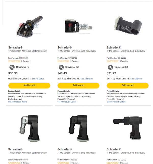

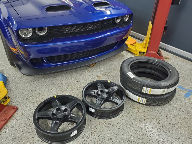

This is not my first rodeo, I have driven on drag radials and skinnies before... thats not what I'm asking here. But for what it's worth, my car is NOT a daily driver. I just drive occasionally on nice days, it never sees rain, and I don't go corner carving as I've got a better car in my stable for that. It only has 700 miles on it in the past 6 months to give you an idea, and this rate will actually go down because the first 500 I was trying to get quickly for break in purposes.
I chose the MT Sportsman S/R 28x6 because it's a radial tire that is suited for street use. Look it up if you don't believe me. Ron Silva runs this as his everyday setup as well. Not only will this help me preserve my original wheels and tires for future collectability, the front skinnies will also help reduce the chances of rock chips from the front 315 drag radials picking everything up.
So if anyone has any helpful suggestions on TPMS sensors, please jump in.

F6990EE6-C172-4894-84A1-4B8420AF7750.jpeg 105B1820-91BE-40DE-AF16-06D4536E326B.jpeg 247F2D07-D3D8-4B3D-977C-F7EE5D64616B.jpeg
They look badass too!
