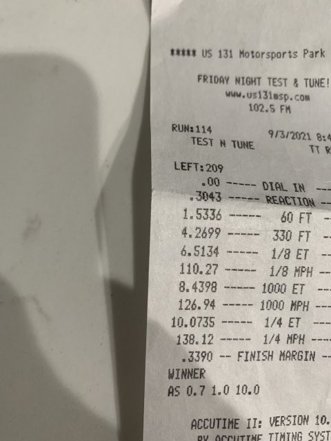

So on my normal tune at the track if I have a low 1.5 60ft at 137 or 138ish mph I am seeing 10.0 or a 10.1.
I am just on my phone right now and haven’t read through everything. But with your 60ft the times you are getting don’t surprise me.
the knock issue is weird. A shop down the road from my house is 150 bucks for an hour of dyno time. You may want to hop on there and see what all you have going on.
That’s a lot of knock but it sounds like you pulled timing and it went away? That’s odd. I’d do some street pulls with pulled timing and see what happens and slowly add a degree or two back in and see where it happens again.
4,363
10,843
I will tell you last night at the same track I did 1.44 60ft at 2 months ago the best I could pull off was a 1.5. Prep wasn’t the greatest. I actually had wheel hop for the first time since the aad kit. @Phast Hemi told me to go up a pound and that seemed to help for the conditions given.
here is the time from a 2.85 pulley e85. I did have some stkr on this pass so I’m assuming that’s the issue for the et being only 9.90. But the 60ft was a 1.44

Well, is there a 9 sec time slip? Hoping you got one and just didn't post it....
3,933
9,717
Thread Starter #134
9.6. Shooting for lower 9’s this season.
