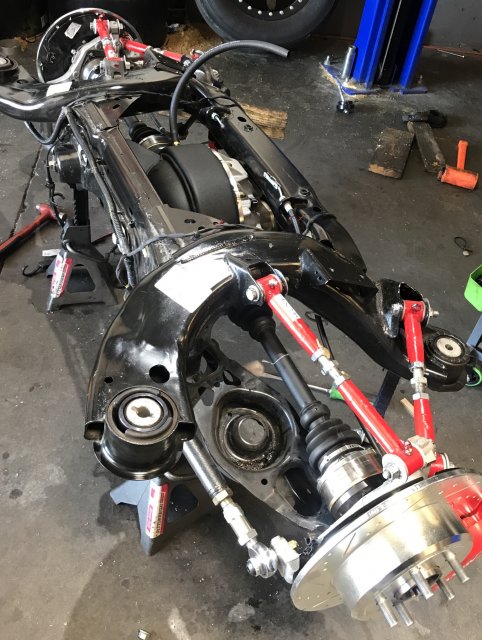

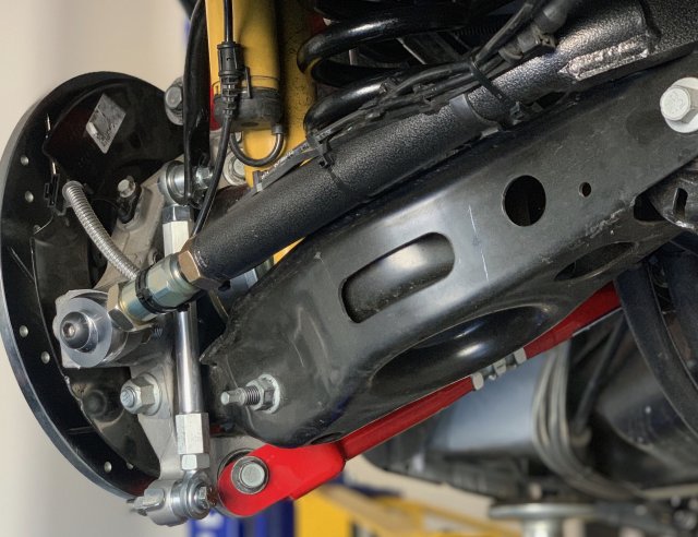

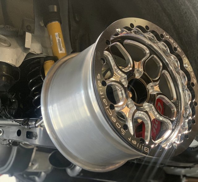

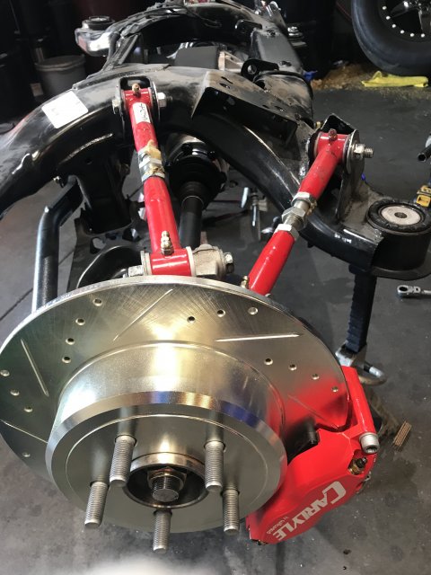

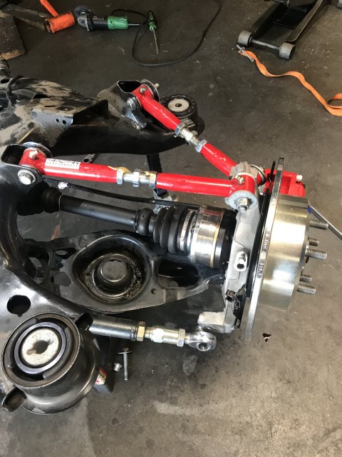

Mine is set up for putting power to the ground in a straight line. It is less than friendly compared to the stock parts and pieces it came with. Stiff in the rear. Noisy when it comes to road and gear noise (having the rear seat delete doesn’t help in that department). I tried and tried to get the Demon springs and gave up. Lots of people selling them but nobody who actually had them. I looked at the “Demon killer” springs but they lower the car in the rear. With the tire I’m running I couldn’t have that. So..... I bought the Scat Pac1320 “Drag Springs” from Mopar on a good report of how they ride and transfer weight. We’ll see. The set I bought was the complete package that includes sway bars. Much lighter than the Hellcat bars. I am not running a front sway bar so that stayed in the box but I did install the rear bar. Control arms are all Spohn Chromoly adjustable. The toe links are BMR with the special skinny heim joints for the 15” brake conversion. Cradle and diff bushings are all BMR lock out. I do not use a diff brace because it is a steel 9” conversion. The cradle has been out so many times now that it thinks it lives on the floor 😂. Here are some pics........ 5C7BE2B2-2768-454C-B5A3-50FB9D4637AD.jpeg 7B91C39C-74D4-4013-AF2E-9D73558DD1CB.jpeg A2736A5B-1293-4D8D-BFB4-7D574DED620A.jpeg 25E0CF79-45F1-47E4-89F6-0ED729BD8752.jpeg 688627E6-C23B-40CA-BE28-128A2522C725.jpeg

Mine is set up for putting power to the ground in a straight line. It is less than friendly compared to the stock parts and pieces it came with. Stiff in the rear. Noisy when it comes to road and gear noise (having the rear seat delete doesn’t help in that department). I tried and tried to get the Demon springs and gave up. Lots of people selling them but nobody who actually had them. I looked at the “Demon killer” springs but they lower the car in the rear. With the tire I’m running I couldn’t have that. So..... I bought the Scat Pac1320 “Drag Springs” from Mopar on a good report of how they ride and transfer weight. We’ll see. The set I bought was the complete package that includes sway bars. Much lighter than the Hellcat bars. I am not running a front sway bar so that stayed in the box but I did install the rear bar. Control arms are all Spohn Chromoly adjustable. The toe links are BMR with the special skinny heim joints for the 15” brake conversion. Cradle and diff bushings are all BMR lock out. I do not use a diff brace because it is a steel 9” conversion. The cradle has been out so many times now that it thinks it lives on the floor 😂. Here are some pics........ View attachment 897 View attachment 898 View attachment 899 View attachment 900 View attachment 901
That is some good stuff Marc!
Killer Setup!!!

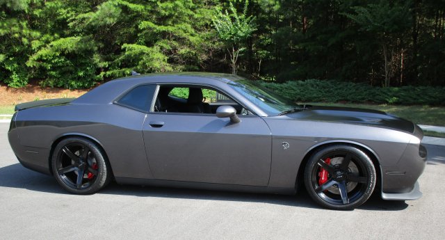

Only Mopar lowering springs.
Got them from @Blkout
Made dealer install before I picked car up.
Wish the rear was maybe 1inch lower though.
Hunter, I cut a half coil off my previous rear set of Mopar springs, it gave the look you're probably wanting but I tore two rear axle boots while they were installed over the course of about 10k miles. Not sure if yours would do the same but that's why I went a different route this time. I cut a 1/8 coil off my factory front springs and a 1/4 coil off my factory rear springs. It's not as low as before but I haven't torn a boot since.
