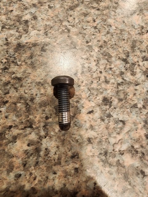

What I found changing fuel injectors
20,163
Holy cow that's a pile of junk that came off the original.

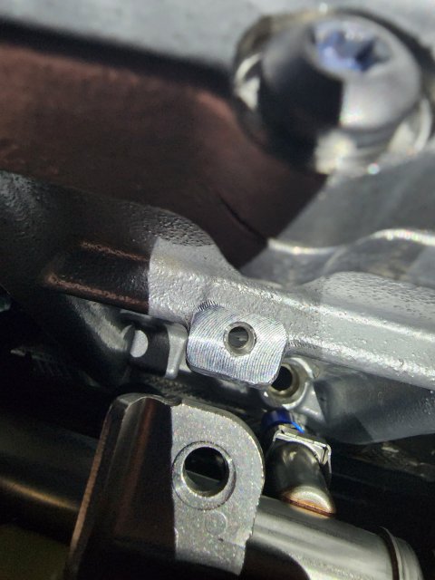

Torque spec is 9 ft lbs I "think".
It probably should be converted to in-lbs and use an in-lb torque wrench @Idoru99. I don’t know if 9 ft/lbs is the correct torque or not but that’s 108 in-lbs.
7,644
20,030
I looked it up and it's actually 7 ft/lbs or 62 inch/lbs so nothing really. I'd just snug it down by hand. I didn't torque mine.
4,976
11,945
I would definitely not reuse the old screw. Use the HD screw w/o loctite until you can get an exact replacement. Ebay is a good place to find low quantities of odd screws. I would not trust ebay for a life critical screw, but for threading into alum I would be ok.

Finally all buttoned up. Had to order a couple fuel injector retainer clips (lost one in the engine bay abyss and ordered extras). New T30 bolt in the mail (used HD one for now). Pressurized the system and didn't smell or feel any gas. Since I finished around 11pm, I didn't start the car and wake the neighbors, or my wife ;). I'll do that tonight.
