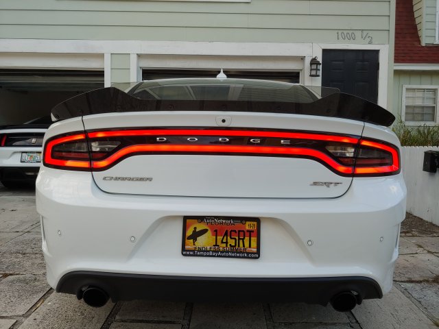

After 1 yr of ownership, I finally cleaned the Wicker ZL1 rear spoiler. Gets a little nasty at the screws. 😣
Car day today at 72 and all the flies went up north.
