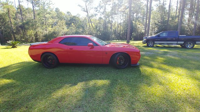

UFFFF those rims!!!!!! I know they were $$$$ but they look GOOD!
Thank you. Biz @ Triumph is an artist!

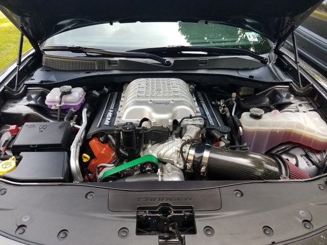

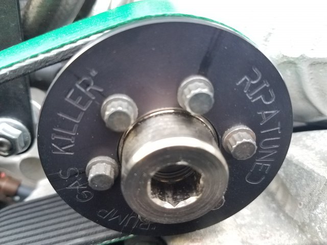

I'm taking the car to Peitz Performance for some mods. 2.85 upper pulley, 180 thermostat, off road midpipes, tune and transmission tune. They will also install suspension links so my 17" rims will fit properly.

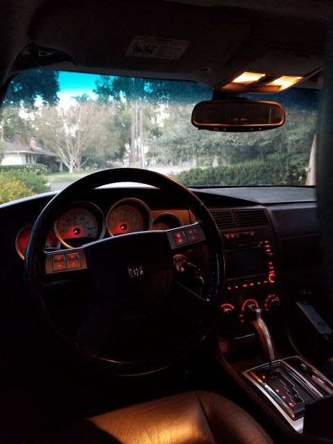

Cool, I like it. Any how to posts for this?
It's pretty straightforward.
Remove from car.
Remove from bezel.
Remove knobs.
Pry open.
Replace existing LED with a 3825 SMD LED of your liking.
Reverse process.
If you want it brighter, do a little ohm's law math magic to determine the threshold resistance for your LED of choice. In this circuit, they are modifying the forward voltage and current. You'll need the current rating of the led you're using and go from there.
I'm a vendor on another forum and have been doing led light mods on Chrysler/FCA vehicles for over 10 years. Let me know how I can help.
Here's a recent photo of the wife's 2005 RT Magum, with red LEDs and custom lighted pointers, in red. 20190813_194245.jpg

That is just "To Cool"!!!!!
