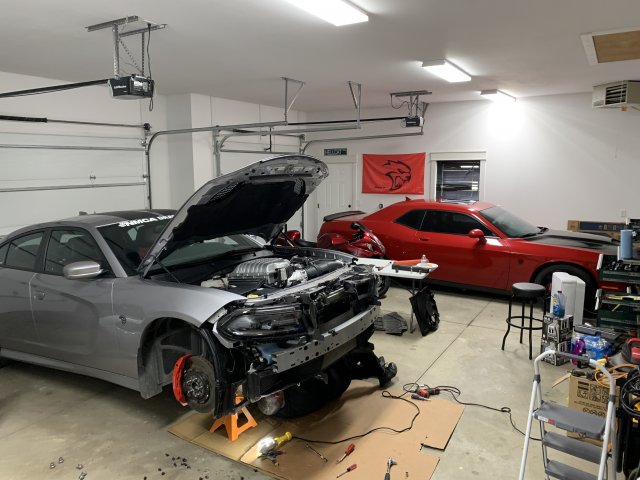

We pinned Jon's crank a few months ago so today did mine. Neither then @jonx96 trying to cut his finger off on my car it didn't go real bad. On a Challenger those plastic pieces come off above the radiator where the chargers it is attached to the bumper. For some reason we thought we needed to get in there and pulled the bumper off. I have done it a few times and it isn't hard just time consuming with the pins and bolts that connect it. So that added way more time we didn't need to do:rolleyes:

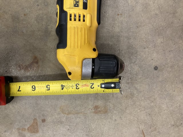

OMG!! You guys never heard of a compact right angle drill and a short bit!! Drop the fan out, remove the bolt, drill it, install pin and bolt, put fan back in DONE!! ( no lost fingers either)

Yes. We used my right angle drill. For some reason we thought we had to remove the bumper. The challenger we had to rip up the radiator cover plastic turns out the charger you don’t have to.
I cut my finger take the crank bolt off. Something slipped and my finger hit some really sharp plastic under the car. Went to a walk in urgent care. They wanted to stitch it. I told them to just glue it.

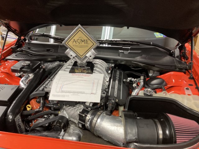

Me today? Went to first car show of the year at local college, took first place in their dyno completion!! MUCH THANKS @jonx99 for fixing my tune!!
BF348BCE-E0A2-4645-9DEA-3A0AE8B0DCE6.jpeg E36D5CAE-F61D-4123-8930-72AAC8C1BD2F.jpeg
Set a new 69-130 PB with his latest tune update as well!!! Dude knows what he’s doing!!
View attachment 67563 View attachment 67564
HAPPY DAY in the neighborhood 🍻
Want me to start working on the snap crackle pop. Be a great day I’m the neighborhood for anyone who likes cars 😂 bad day for everyone else. Crazy how just reworking somethings added 25 ft lbs of torque.

Sometimes something gets in your mind and you go with it. We should have left the bumper and only taken it off if we ran into an issue but sometimes you do the wrong thing. Between the daytona and hellcat I have removed it over 5 times so I know how to do it. I knew what needed to be done on the bottom and Jon did the top the last time and he couldn't remember why but thought we had to loosen something we couldn't get to
But yes for the most part you loosen the radiator support on the bottom and pull the fan out. Really need a tool to hold the teeth of the flex plate instead of a screw driver if we do another one

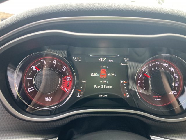

Yea, torque was up, you could feel it too!! I think HP too, everyone was complaining the dyno was about 50 Hp shy. I could agree as it was in STD and another dyno 800 ft higher in SAE said 947/850 just last week on a milder tune, todays dyno in STD said 945/878 but the car had more timing and street testing just before the show said it was faster then ever before, PB in 60-130 and also most sustained G’s ever in third on another test bridge I test 3rd gear pull on always, PB of .84G on that bridge on the way to the show this am on a 31F bridge, it’s new concrete grooved across the road and grips like your on 20 grit sand paper.
What was this before the .84g?
I'm not sure off the top of my head, I think mine is only like .74g... Now I have to go look...

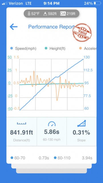

Hey @16GoManGoHC2 this was done on a 2.85 here. Let’s bump your numbers up 😊
But was done from a dig not a roll
That’s the exact same G’s my car displayed when I ran the 9.998 Pass at the track on the 315/50-17’s when I also got my best 60’ever of a 1.39. You sure that’s not my picture ??
Your lucky, I see from the dash it was done in a sissy automatic 😂
Max G on my test spot for 3rd gear pulls was .74 G’s as well until this mornings pull

Cars pulled much more G’s then .84 at times, I just use that hill as a power test and 3 gear fits it, I roll onto the throttle about 25-30 mph in third and just hold on while it builds, (2nd would be spin city, M6 remember) and it gives me an idea on power + or - on tune changes, been recording 3rd gear G’s on that hill for probably 2 years

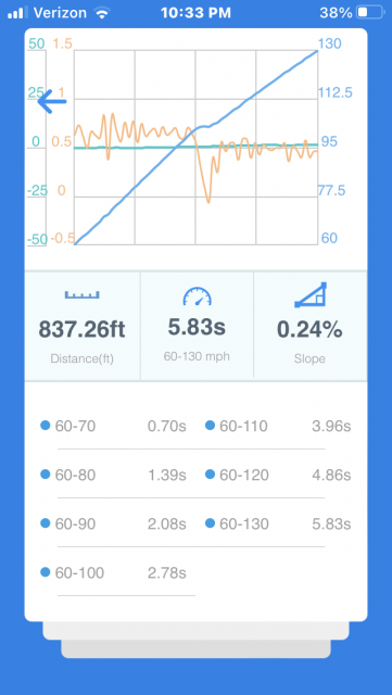

Here’s over 1 G in third but this is on a flat 60-130 run and isnt continuous G’s like the up hill bridge pulls, this is slip and grab G’s but still plants you in the seat and at 70-80-100 mph feels GREAT!!
