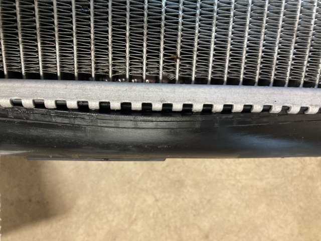

Good move, you don’t want this, PISSED me off BIG TIME. Just installed rebuilt engine in a spotlessly detailed engine bay and car underneath tooth brush clean including tranny, DS, rear, axles, etc and 14 Qts of fresh new antifreeze covered it all and then was a FU*K to get home with a radiator torn open like the Titanic’s hull after hitting an iceberg.

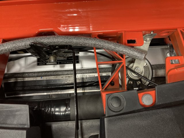

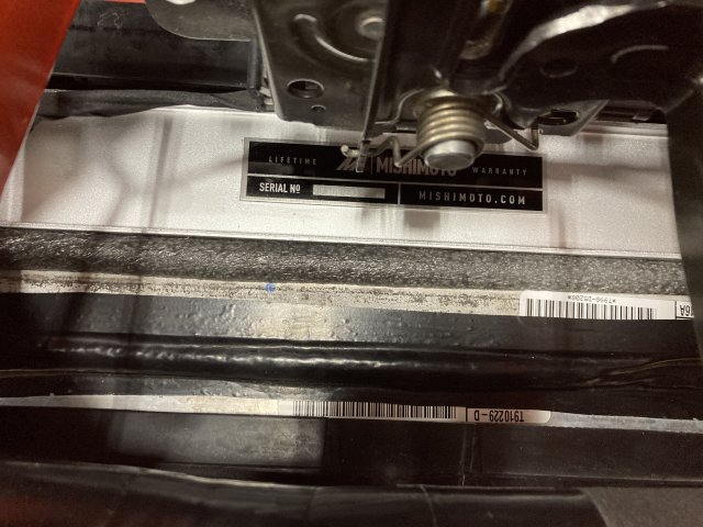

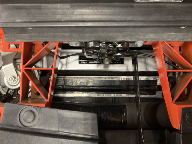

If you really want to get maximum efficiency out of the install get some of this foam backer rod from McMaster and seal the gaps between radiator to intercooler and intercooler to condenser so the fan pulls air through the whole stack not from leaks between them. Position the original upper and lower rubber radiator caps over one groove on the new radiator seal the gap between the stack and the upper and lower radiator mounts so all the air caught in the front air dam has to go through all the coolers not around them. Cover with 1 1/2” wide Scoth Super 88 Electrical tape for that factory look and seal.

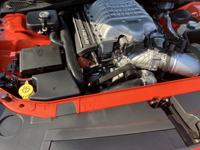

Got my under hood covers back, from Advanced Custom Coatings, Texas.
All carbon fiber dipped, with ultra clear coat.
So excited, I had to share. I'll post up some more pix, when I get them installed. For now, Czech it out:
JLT coolant tank cover.
JLT intercooler tank cover.
ABS cover.
Fuse box cover.
Strut cover.
Fuel Rail Covers.
If you like the work, give Kim a call and tell her I sent you.
I'll post pix of this stuff installed, this weekend.
Bob
View attachment 51537 View attachment 51538 View attachment 51539 View attachment 51540 View attachment 51541

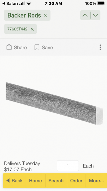

The Rod I used is 5/8, don’t worry about the heat rating of 160, it gets hot enough to glue it self to the radiator but the rest of it stays cool enough to remain intact. I couldn’t get links because my McMaster app on my phone would open and be a pain so here’s 2 screen shots of the rod and tape, part numbers are in there. A423F2D2-777D-4493-A6DE-69C1E237D903.png 1DC698E6-456C-4CE3-80BC-EC1BE5EBD108.png
