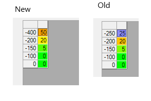

Electronic Throttle -> Min Desired Throttle: New Value 0.10, Old Value 0.03.
[ECM] 3520 - Minimum Demanded Throttle Voltage: The minimum allowed throttle setpoint voltage.
It was discussed before that the throttle body is an issue in the PCM update, if someone more knowledgeable than me could chime in on this parameter that would be appreciated. I believe there have been multiple comments by @Trucker Bob and @Blow By about the throttle body. This definitely was changed in the update. .07 is a sizeable increase. Changing a value by seven percent can do a lot of things, e.g. fuel trims...
Edit: just a moment of clarity. This is the startup value of the throttle body, what does a throttle body do when you turn the car off, returns to the default minimum point. No wonder it sounds like my fucking car is farting, it's a half assed whistle...

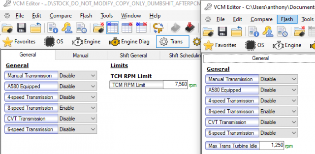

Now to discuss Transmission, this is where things get weird for me, in my pcm read prior to the flash the only thing that shows up in the Transmission section is General, Manual and Torque Management. I don't know if there is a bug in 4.4 but in the beta 4.7 new tables have popped up for me, these are: Shift General, Shift Scheduling, Shift Pressures, Shift Timing, Torque Converter. This may be a unique thing to me or a bug. This is beta software so I cannot tell at this point.
Transmission -> General
New to me: [TCM] 5722 - TCM Limp RPM Limit: If the engine RPM exceeds this TCM RPM Limit, Limp mode will activate and a DTC may set.
New is on the left, old is on the right, one option is missing, and a new one has appeared...

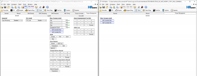

All new in the comparison, may be a bug. If you would like these values if they are indeed new, please let me know and I can post them.
Transmission -> Torque Management

So there were quite a few changes in the new update, mostly around throttle body and torque management. I have nothing to say about the Transmission tables that are new to me because that might be a bug with the 4.4 software when I did a stock read of the PCM. Who knows what is really going on. Figured I would bring this out into the open for others to comment on, please let me know your thoughts or if there is any other data you would like to see. In other news my VCM Scanner is working as expected and I can see all my Channels again in the Beta.
