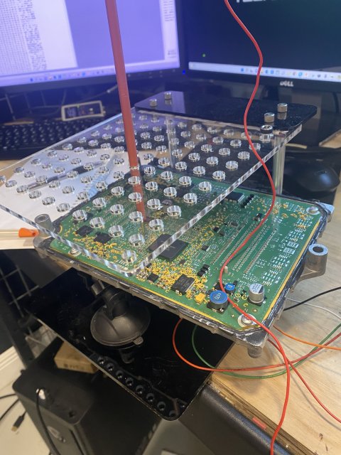

@white1 the in house unlock equipment you bought are you going to be able to unlock 18+ for hp tuners?
white1
#5684
267
411
Prairieville
LA
2020 hellcat charger widebody
Yes. The only 18+ we've done so far is for a 21 TRX, but should be doing one for a hellcat durango this evening

2ndgen
#1309
407
649
Orem
Why is that board covered in crushed ramen noodles?
If those are all patch jobs.... ouch.
white1
#5684
267
411
Prairieville
LA
Have to ask the manufacturer of the PCM. They all look like that when the cover is removed
white1
#5684
267
411
Prairieville
LA
Please elaborate... and thanks for sharing
There is a small component there you attach to in order to read the ECU you first read everything, make the require modifications to the code and upload the new code
Can you upload a better picture of the board and Ramen noodles?
