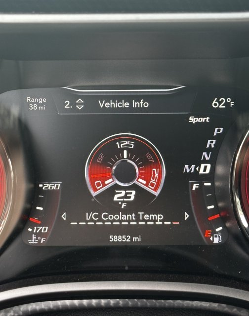

Got rid of tank, had a small pinhole in it on the weld. Redid the lines, took care of some additional leaks from AN fittings. IMG_3859.jpeg
chilly 🥶 this is driving around with car up to temp, not just sitting still idling
