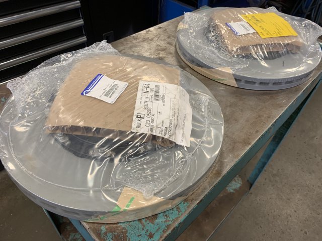

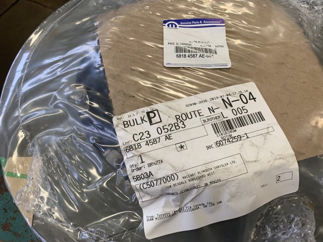

Markp
#968
5,219
27,250
Fuck Trudeau
Had my rotors replaced under warranty. 818C5781-C9FC-445D-85CD-195EC47427AE.jpeg BD99D1A1-9653-45DC-9997-6C2004EA8D06.jpeg
