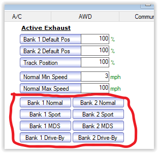

I checked a 2015 M6 and 2016, 2017, 2018, and 2019 A8. All had this setting at 100%. These were all Challengers. I don't have many Charger files to look at.
What I don't know is if this 100% setting is all the time, under certain conditions, or over rides anything in the tables.
The default valve position = at rest, unpowered = full open.
The tables below...Bank...Normal, Bank...Sport, Bank...MDS, and Bank...Drive By are in effect depending on what drive mode and the associated parameters as shown in each table. Track Mode there is no table, just the full open 100% position.
