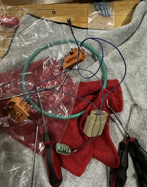

Yeah, not sure how that’s going to work with a regular hellcat plug which is why I was asking. Looked like 3 wires
3 wires over on the passenger side unit as well cause the only thing I’ve ever found over there is fuel level pick up sender, which is usually three wires, voltage across the resistor and one for the wiper?
8,743
7,677
33 wires over on the passenger side unit as well cause the only thing I’ve ever found over there is fuel level pick up sender, which is usually three wires, voltage across the resistor and one for the wiper?

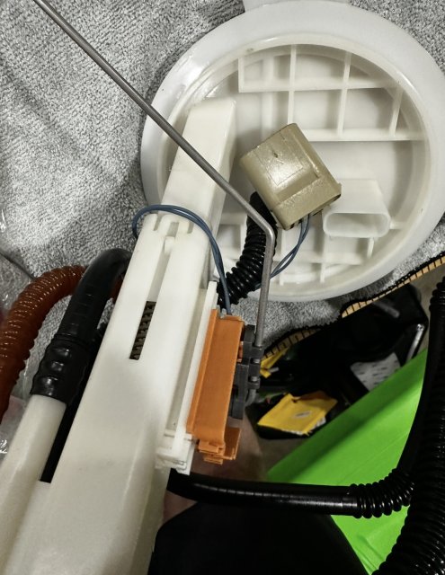

My fuel sender on passenger side is only 2 wires (just replaced it on jet pump) and the connector on passenger side only has 2 wires (2015)
8,743
7,677
Had to depin the plastic plug and slide in the new wires for the new sending unit
