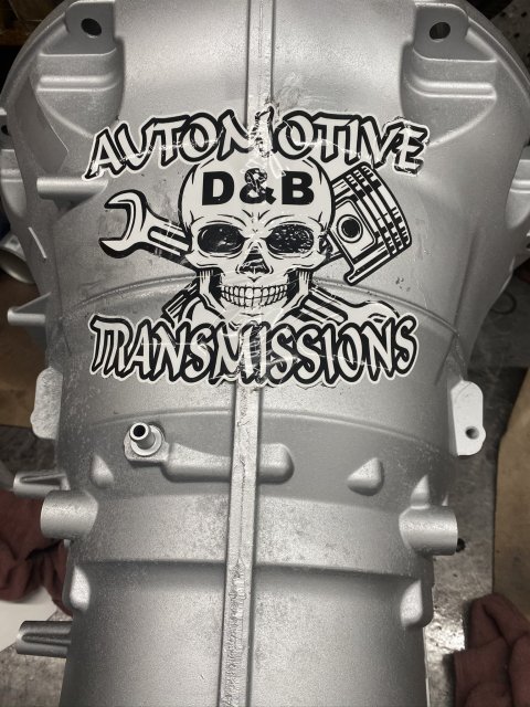

8HPXTREME TRACK TESTED in an 8second car 😁
daaaang let’s go! That things got the sauce
Hellno is the way to go! Dave is a true domain expert.
I agree with this . He testes his stuff to the max in the real world .
