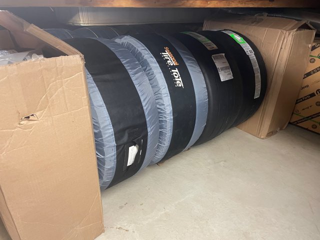

Looked up Drag radial storage.
Says I should be storing my tires on their side. 851E349D-AAC6-4D3C-9DA0-B17696F3B452.jpeg

Yeah they flat spot pretty easy....
